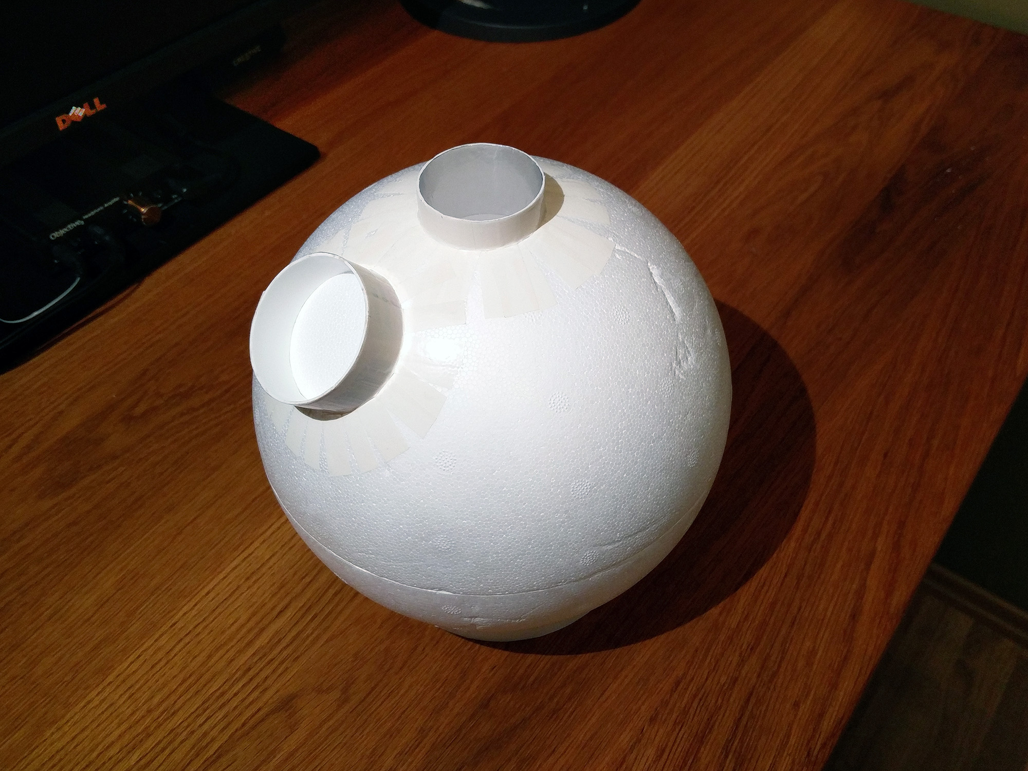

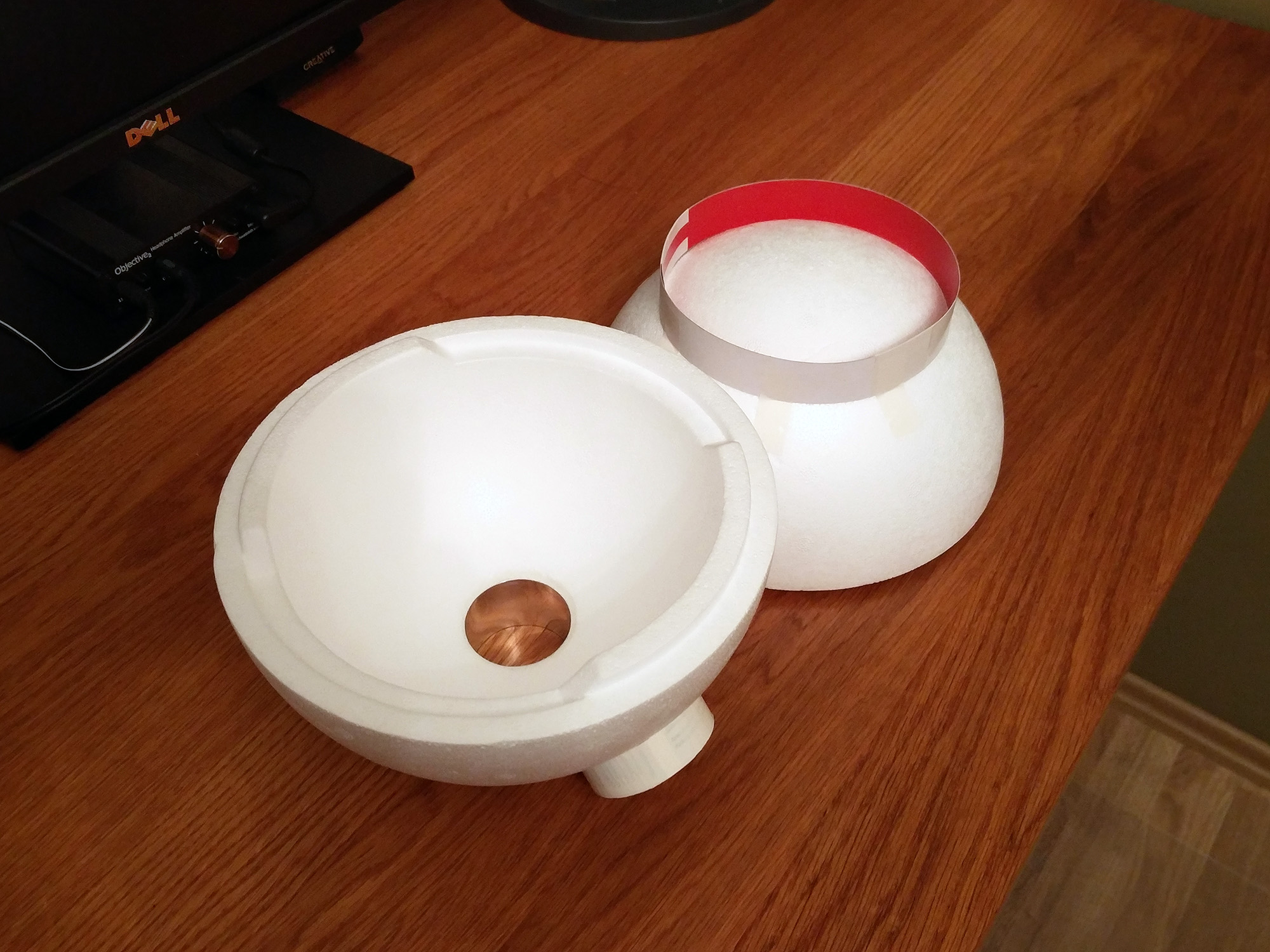

Cool! What did you use for the base and the “rings” for the light entrance and light meter? Looks like the base is thin cardboard? And the rings thin PVC?

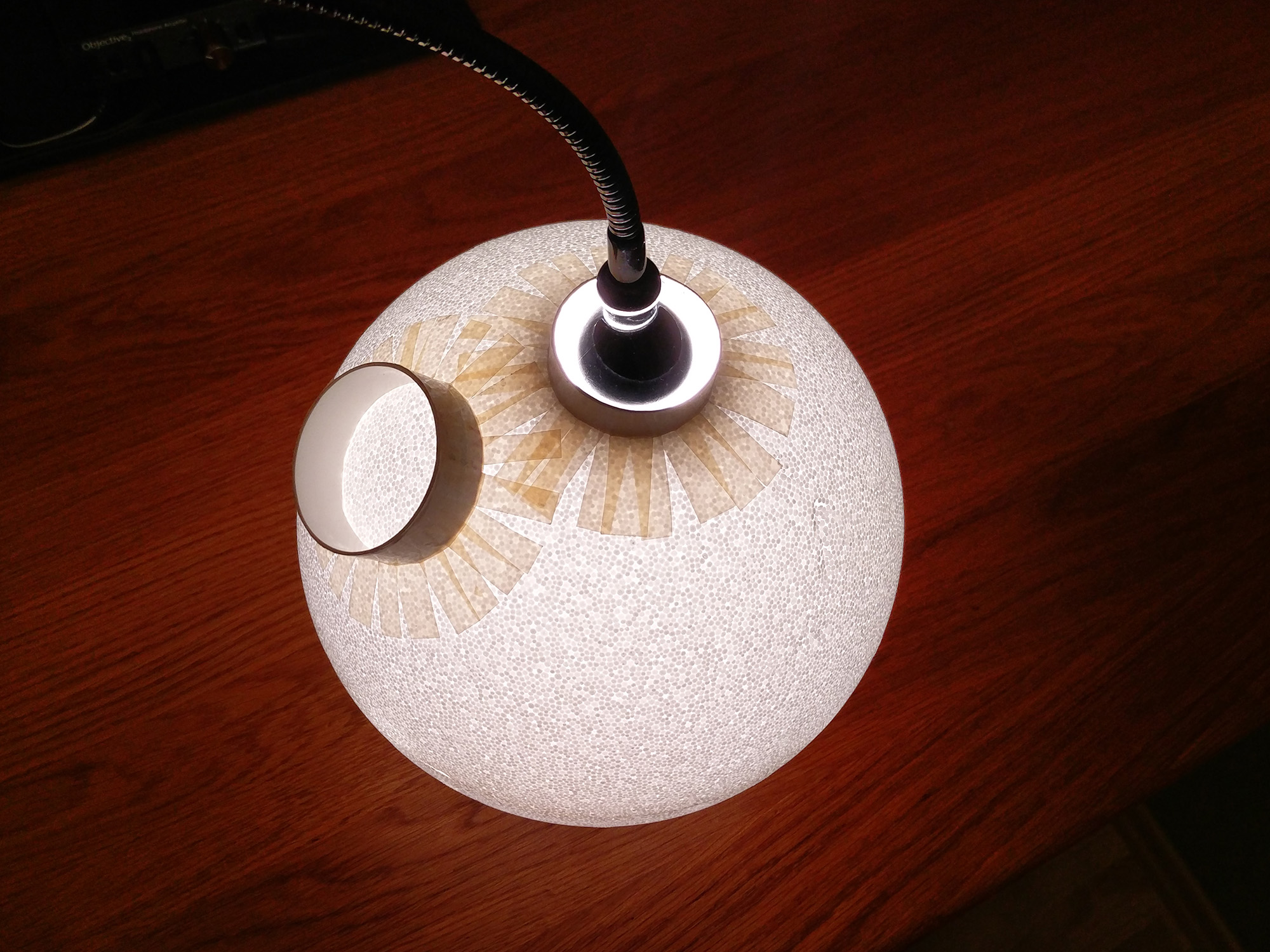

Looking immaculate! ![]()
I see that your entrance hole is quite long, so could you do a little experiment for me that I’m curious of?: could you check how (in percentage) the luxmeter reading differs while you move the flashlight up and down the hole. The reflecting mirror surface should make that the difference is not much (all light should be directed into the sphere, and the reflectivity should not differ too much either), I would like to know how much.

Yep - all the assumptions are correct. Base is just a ring of cardboard and the rings are made out of plastic pill containers. I managed to find the exact right fit for the light meter, so I don’t have to fix it with tape:)

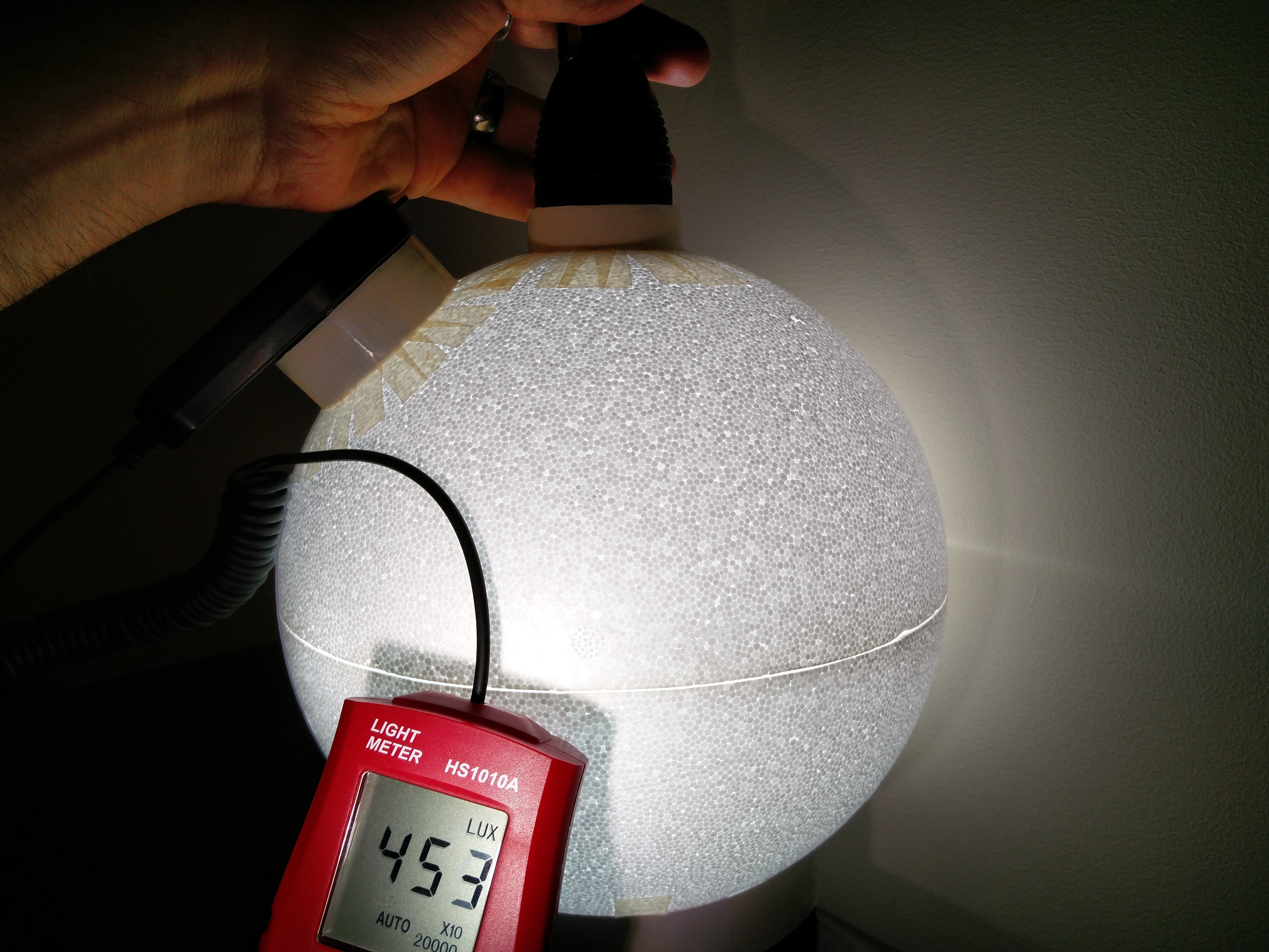

First of all a little explanation why I left entrance port longer. I wanted to keep the inner surface vs ports ratio very small (about 3%) and still get a usable reading form some lights that are just a bit too large for the opening. So I tried to be a bit sneaky. I hope the pictures explain my plan a bit better…
The port is covered with aluminum tape, depth is about 32mm and the diameter is almost perfect for X6 and D80. So these will be the test lights.
X6 triple test2 – different output mode
So basically very little difference in lux reading when traveling almost 3cm up or down. When the head is pushed too far down inside the sphere, there is off course a sudden drop in numbers.

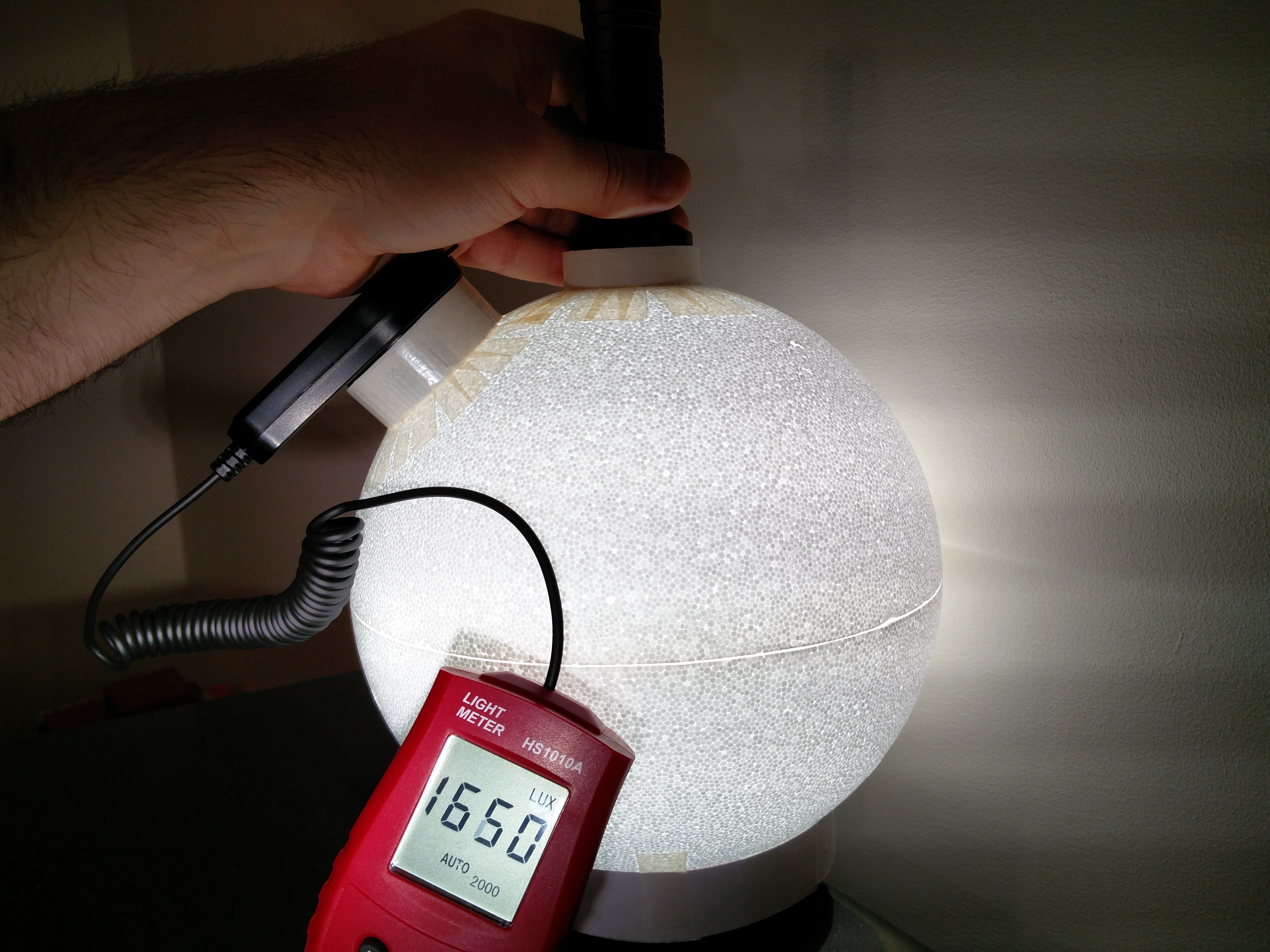

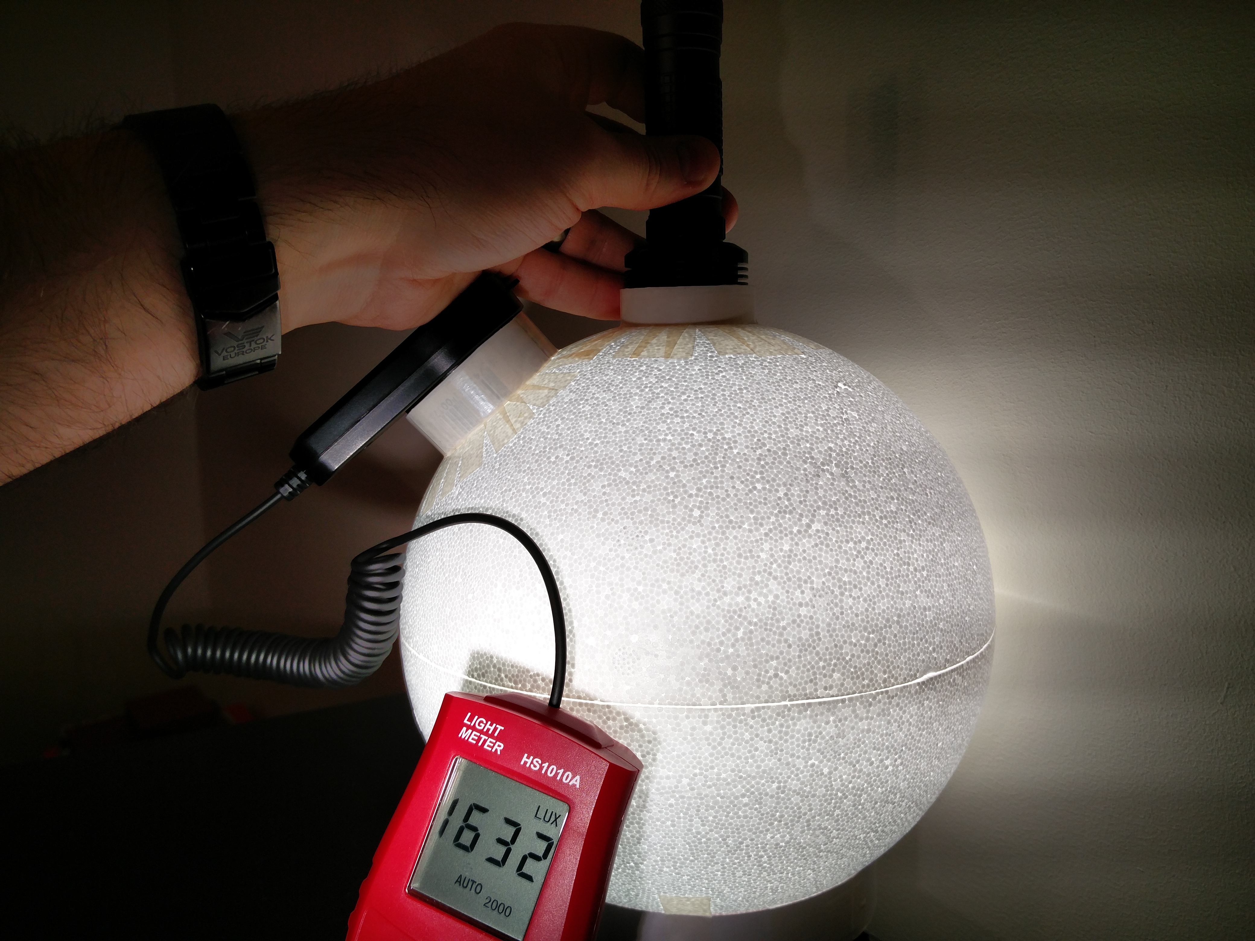

D80 test2
The last picture shows a drop, because the head is already too deep inside.
But as you can see, the numbers are not so stable anymore. Almost 10% difference. My best guess is that the culprit is reflective bezel?
Thanks a lot for the measurements ![]()
So the position in the entrance hole does make quite a difference, even with its reflective walls. Pity, that implies that you will have to define a fixed depth for your measurements (not that much of a problem though). Yes, it is the reflector that is increasing the overall reflectivity of the sphere, and when it is too deep in, the side of the head is eating light, and with so many reflections going on, it is soon adding up to a considerable loss of reflectivity. With a bigger sphere the things going on in the entrance hole will have less influence on the reflectivity (multiplier).
