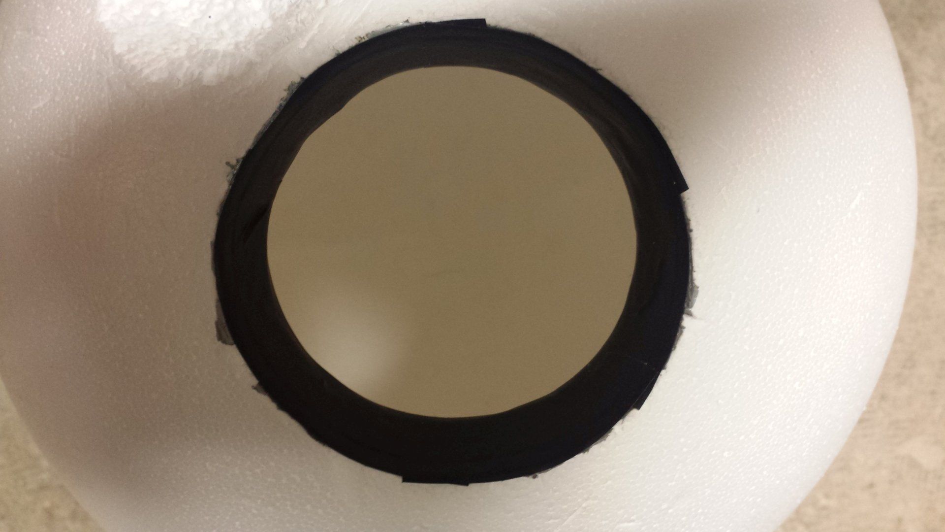

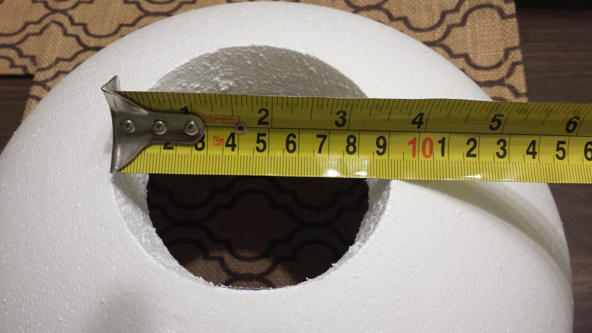

My integrating sphere (or as my 3yr old says, “integrating spear”) is nearly complete. I started using duct tape instead of aluminum tape but then realized the duct tape lets an awful lot of light through it, so I used black electrical tape over the duct tape. Some pics:
The hole ended up at 90mm and tapered in (hope that doesn’t hurt me):
Created an indent for my luxmeter sensor which made it start to look like the Death Star :slight_smile: :
Dug out some more “foam” to get the sensor to sit in place a little deeper and make it easier to get in the same location each time:
Luxmeter sensor in place (will likely add velcro strap):
Taped up entrance hole:
The way it will look once finished, after mounting two sections together and attaching to the base:
-Garry

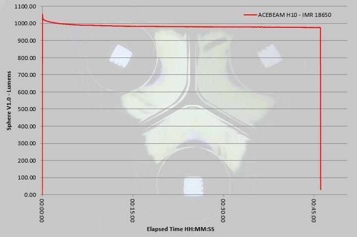

Nearly all of my lights are modded except two so finding calibration lights is difficult but one of the stock lights i have is the Acebeam H10 which appears to have fairly steady regulated output of around 1000 and 2000 lumens.
With the Acebeam on high i get a reading on the 20000 scale of 490 (x10) and turbo sees a 980 (x10) reading so coincidentally i’m basically doubling the screen result to get the rough lumen output which should be around 1000 and 2000lm respectively?
Or should i be applying some formula?
The Klarus Mi7 shows 260 (x10) on high and 33 (x10) on low mode, which when doubled gives 520lm and 66lm - not too far off these results
Thoughts?
