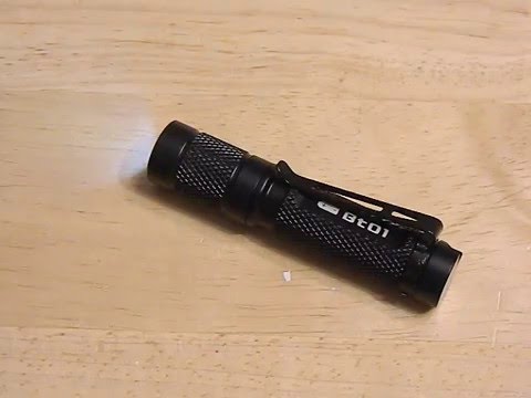

How honored am I that I literally got to be one of the first people to review and test the Bronte BT01? I’m psyched.
So this flashlight is new to the states and I gave it a thorough testing and am ready to present my results to you guys!

This light is built well. The annodizing, threads, and glass all seem good. The pocket clip is significantly stronger than my Ti3. It is a tiny bit smaller than the Ti3 as well. Simple design, and the modes change pretty smoothly without problems.

The BT01 does fall below the pack when it comes to runtime. However is very competitive when it comes to brightness. Bear in mind that my level of error may be 10-15% so they are definitely pretty close. Considering how small this light is, it puts out a tremendous amount of light, and has a pretty impressive runtime with Energizer Lithium batteries.

At the time of this post this light is $13 usd. The only comparison light that is cheaper is the PA01 which runs around $12, and as you can see it is not as bright, and doesn’t run as long. This light is a very close replica of the Ti3 and has a similar brightness. The only area lacking, and my only complaint with the light is runtime. This light makes a very good option for a small edc light, or an extra light to hide in your desk at work or in your car. Seeing as Bronte is new to the US market I’m pretty impressed at their first offering. If Bronte can increase the runtime in the future and still maintain that $13 price this light is going to be a home run.
