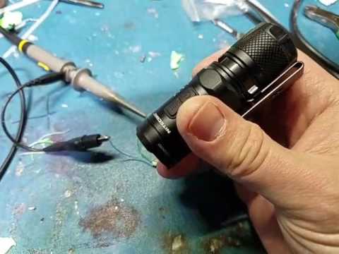

MELD-X now support dual switches, which makes the user interface enormously more intuitive. Dual switches can be activated using an option in the menu. In dual switch mode, either switch can be used to enter commands or turn on and off, but ramping and min/max shortcuts will go a specific direction based on which switch is pressed. I just recently finished installing a MELD-X 22mm driver in a Nitecore EC11 with dual switches and it is awesome. I will do a writeup of how that mod was done soon as an example to help others set up dual switch lights.
Here is a demo video of the new features;
Both of these changes are to the momentary firmware version only, but the PWM speed option will be added to the clicky version within a few days.
I also have a version of the board that fits in a Nitecore EX11 (my EDC) in case anyone has one of those still.
