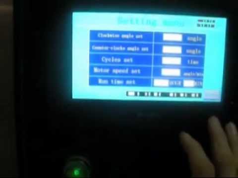

Here is a nice video of a waterproof testing machine (Lisun JL-X), capable of performing tests grades IPX1, IPX2, IPX3, IPX4, IPX5, IPX6, IPX7 and IPX8:
