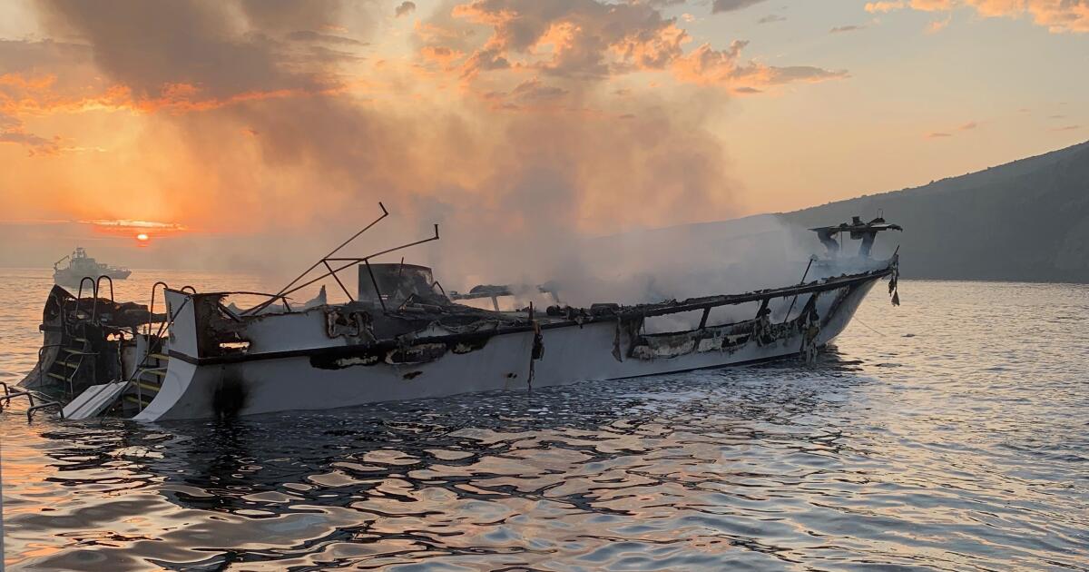

Perhaps relevant to the safety concern: don’t EVER leave a li-ion charging unwatched.
As the anniversary of California’s deadliest maritime disaster in modern history nears, the National Transportation Safety Board announced it will hold a hearing in October to reveal the results of its investigation into the Conception dive boat fire that killed 34 people off Santa Cruz Island….
… A preliminary NTSB investigation concluded that five members of the crew were asleep in the wheelhouse and that there was no roving watch on the vessel operated by Santa Barbara-based Truth Aquatics as required by the U.S. Coast Guard during the hours when passengers were asleep below deck.
But the more extensive examination of the origins, cause and events leading up to the Conception being burned to the waterline has taken months of investigation ….
In the wake of the fire, NTSB and Coast Guard investigators raised questions about the small escape hatch above the bunks of the Vision, a similar vessel owned by Truth Aquatics, and also looked at the charging areas where divers plugged in numerous lithium-ion batteries used in cameras, phones and computers.Some boat safety experts have pointed to the batteries — which have become a staple for divers who use them to power underwater equipment such as lights and scooters — as a possible starting point for the blaze.
After the Conception fire, the Coast Guard recommended that owners of passenger vessels immediately urge crews “to reduce potential fire hazards and consider limiting the unsupervised charging of lithium-ion batteries and extensive use of power strips and extension cords.”
The National Transportation Safety Board announced it will hold a hearing in October to reveal the results of its investigation into the Conception dive boat fire that killed 34 people off Santa Cruz Island and what needs to change to small boats to...
