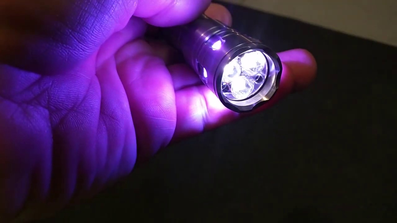

Only now I see that the LEDs are RGB…
I see only 2 traces on that makeshift PCB. How does it work?
Very perceptive Agro. These leds are slightly bigger than your average single colour aux led. AFAIK some need 4 wire control (rgb and ground). These ones however have an onboard controller so only power is needed. There were 2 types of colour patterns that I found. One is a quick three colour change (rgb) and a bit of a flash then repeat. The ones i’m installing are a slow colour change like a lava lamp, exactly the same as L4P rgb switches. Also just like the L4P switches the 6 installed in this light will start in sync with each other but will quickly go out of sync.

As with everything else about this light my first attempt failed…
The lube I used didn’t actually make a good bond breaker. However cling wrap worked a lot better. I got some wrinkles in some of the windows and when I tried to clean the inside shelf with a Dremel I put marks on the inside of most of the windows ![]()
I wired everything up and… IT WORKS… well sort of… I made a slight oversight with driving the aux leds, there’s no resistor so they are way too bright
So can anyone give me hints and tips on how to reduce the power? Negative side of the aux is just grounding through the host. Positive is connected to the main led + which is straight through to the battery +
Put a resistor inline off the + contact…lead on the other end of the resistor
Great! I was hoping it’d be nice and simple like that. Thanks KawiBoy ![]()
