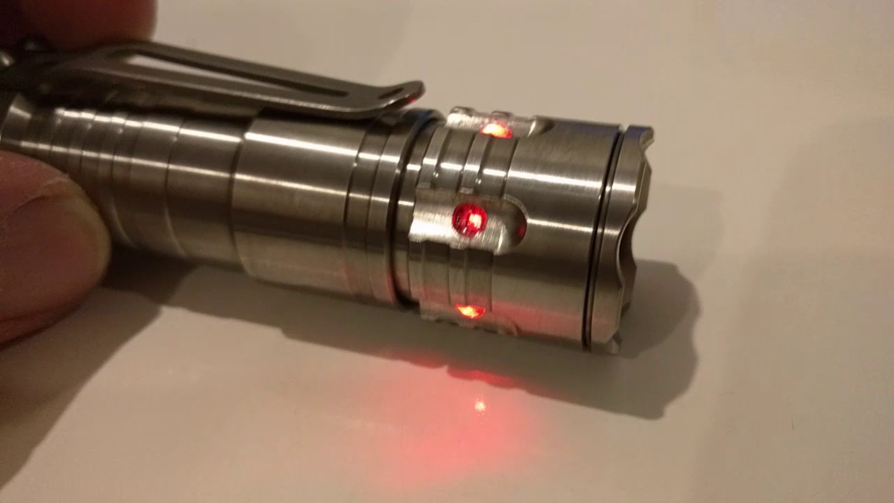

I added a resistor to the aux lights. It didn’t turn out as well as I hoped. Dimming the leds down to the level I wanted wasn’t good for the leds. I guess the blue and green have a higher vf because they didn’t really show at all. In fact when the leds faded to those colours it simply went dark. So I changed resistors to increase the brightness. I got it somewhere in the middle where it’s quite bright in the dark but still not enough power to go through the full range of colours. A little bit disappointing but still a cool modification.

One of the last things I did to this light is add a ring to the head. This ring prevents the head from being over tightened, if that happens it’ll depress the switch. So this stops the thread perfectly to connect the driver without having to be careful. The original system was basically a twisty that used the driver as the end stop.
I had considered blackening the ring to make a black accent to match the tail. I previously showed a pic of a clear tape ring to help electrically isolate the inner tube. I took that off and replaced it with black tape.
Lastly I added a few drops of glue to hold the driver in place. It’s not going anywhere since the led wires are so short but having it fixed in place stops any possible twisting.

wow, looks very nice. Thanks for all the pictures and information.
