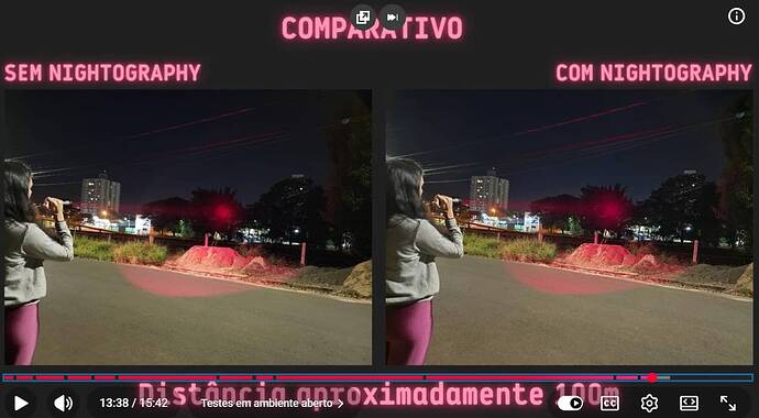

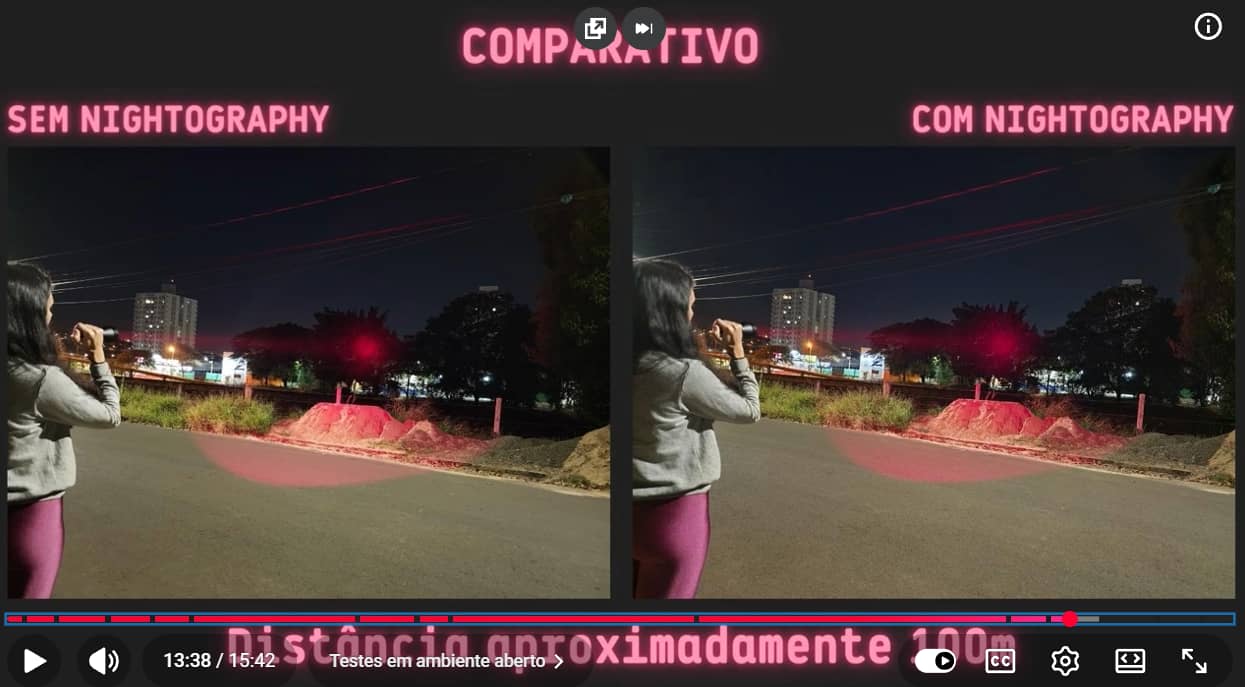

Incidentally, I happen to have a beamshot of the L21B with the SST20-DR (on the right):
You might find this desirable over the C8/M21A because deep red is really, really dim, especially when green foliage strongly absorbs this color.
Thanks, yes, I’m looking to maximize throw with the dim SST20-DR. So it looks like the L21B is the light to beat. Plus it’s available in green camouflage, so that fits the theme of the light for quick visual identification of its purpose.
