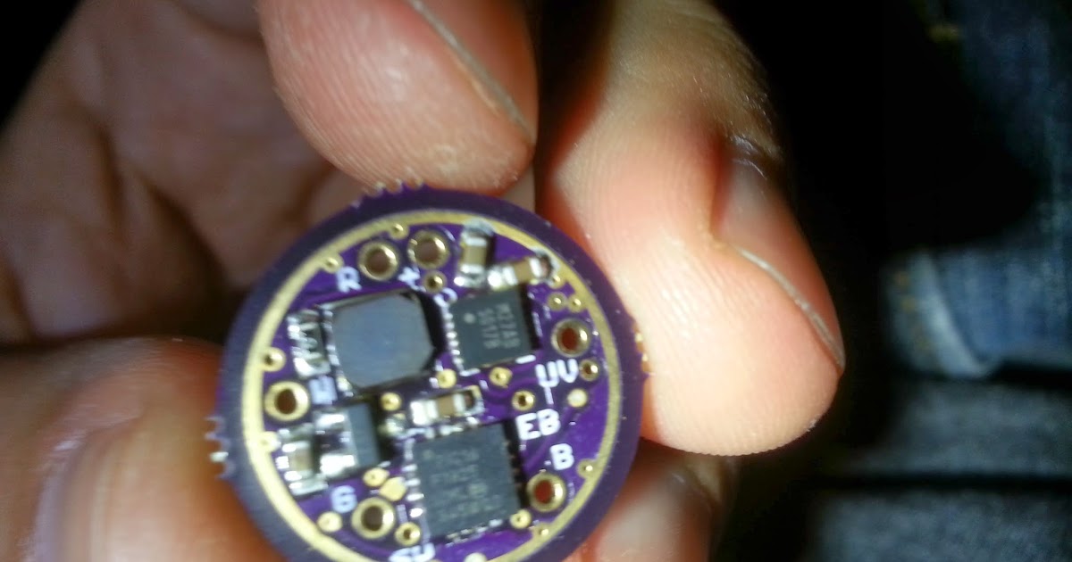

  3. The Knucklehead may be an option for you, but you should understand that it is still in testing. So far it's been determined that it *must* be heatsinked when run above approximately 2 amps. We do not yet know exactly how much heatsinking is required. Rufusbduck plans to do more testing on this. DBCstm does already have one working at nearly 4 amps; it is driving an MT-G2 which is a significantly higher Vout than your XM-L2. The lower Vout of an XM-L2 will put more strain on the driver. If you build one of these you will be in experimental territory.
WarHawk-AVG mentioned that I have a buck driver, but it is also experimental and not yet publicly available. Therefore it's not what you want right now. Here is the development thread.
