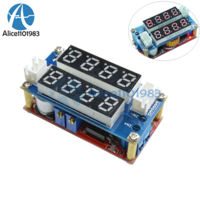

And yes you can charge in parallel, but if you have a weak cell in that parallel it can quickly pull more current than the rest, get hot and kablooey (also putting in different charge levels in the ports can cause high current flow between batteries as the try to equalize to the same voltage)
good call Werner :wink:
Came across these…built in displays for input and output voltages w/ ammeter 5A
(a little more pricey than the ones without the display)
2PCS - $15.96
