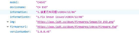

1.0.0.45 is out
Quick test on my device showed that 1.0.0.45 has support for 1.5V Li-Ion and has same issues with “restarts”. Disappointing.

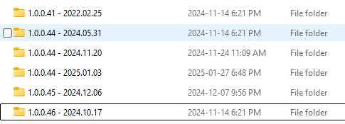

If you point to file sharing online service I can upload to without registration, here is what I have:
Filebin seems popular. Just tested. Seems to work as advertised:
Thanks for this!
Here you go. Please post your test results here.
Are there any updates from users on the latest firmware, regarding both fan noise and cut off for Eneloop cells. Would be nice if ISDT actually resolved the fan issue by swapping out for a larger, virtually ‘silent’ unit.
@Horilka hello! I was wondering if you could do another filebin upload of .45 / .46 I got the C4 Evo for charging 1.5 LiIons and of course they removed the older firmware that would do it, So since not super worried about the NiMH issues as I have an N8 as well I was hoping to find the firmware. I went on deep dive of searching and funny enough I did stumble across 1.0.0.34, so if you want to add to your collection (if you dont have it that is lol) I can send ya that, but this post is honestly the only lead I could find across the internet that even has a chance at the .45/.46 I even just made an account to reply here. I super appreciate it if you can! Thanks!
Here my collection - Filebin | ehioqbh1h0x89gvv
