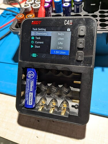

I updated my ISDT C4 EVO to 1.0.0.46 from October 2024
Here are some changes that I noticed:
  1. Support for 1.5V Li-ion has been added (Charge and Destroy modes).
  2. The End voltage can be configured between 2.50V and 3.30V in 0.01V steps for Discharge mode (Li-ion). It previously only went down to 2.90V.
  3. The discharging current can be configured between 0.1A and 1.0A in 0.1A steps, the charging current can be configured between 0.1A and 1.5A in 0.1A steps, and the End voltage can be configured between 2.50V and 3.30V in 0.01V steps for Analyse mode (Li-ion). The discharging and charging currents were previously automatically set to 1A and the End voltage was limited to 2.90V. This change allows you to have much more control when analysing the capacity of cells.
