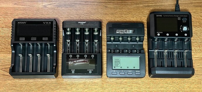

I agree with “Horilka”, the charger is unpredictable and has a lot of problems. I sent mine back to Amazon, they refunded my money, but I haven’t decided yet whether I will order it again. For charging 1.5V Li-Ion I am currently using XTAR VX4, it can also measure the capacity of these batteries. For other batteries I use SKYRC MC5000, LIITOKALA LII-600 and POWEREX MH-C9000. Well, and a few more.

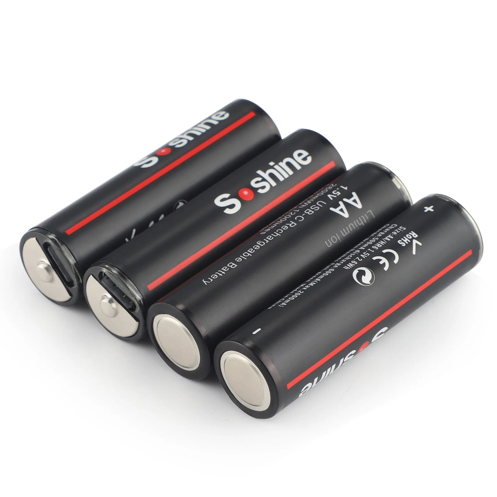

Just tested my C4 Evo (not the Limeta version) with the 1.5 Li-Ion Soshine batteries, and I can confirm TimMc’s results.
Batteries Photo
The firmware version is 1.0.0.49. The charger is connected to the 100W PD PSU via type-c cable, and shows 11.9V on the screen. And it supplies 5.33V and 0.4A to the batteries. I got the same results with a 65W PSU. With a 5V 2A PSU, my C4 Evo supplies 5.19V and 0.4A (I’m pretty sure that the charging current is controlled by the battery’s IC, and the charger itself just provides the voltage and measures the current)
