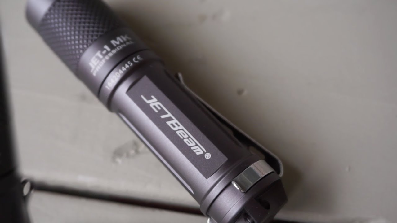

JETBeam Jet-1 MK Video Review
Thank you to everyone who recommended this light to me. It’s fantastic!
I replaced the ugly green tint LED with a Nichia 219B now its a great light
