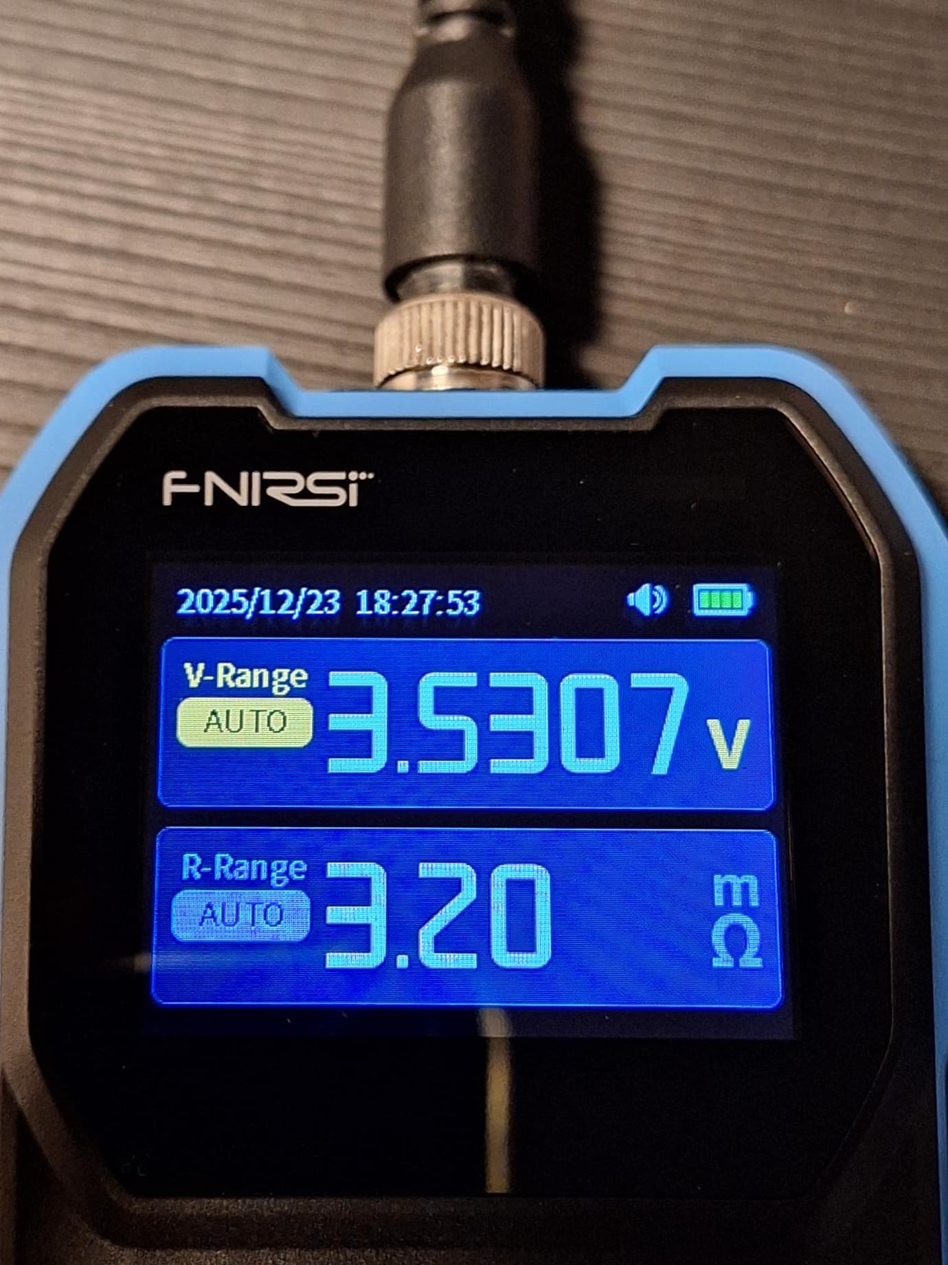

I recieved 2 JP50 (ordered from Nkon):
I just did a quick ACIR (and voltage) check, with the voltage/charge I recieved them at:
Battery 1:
Battery 2:
