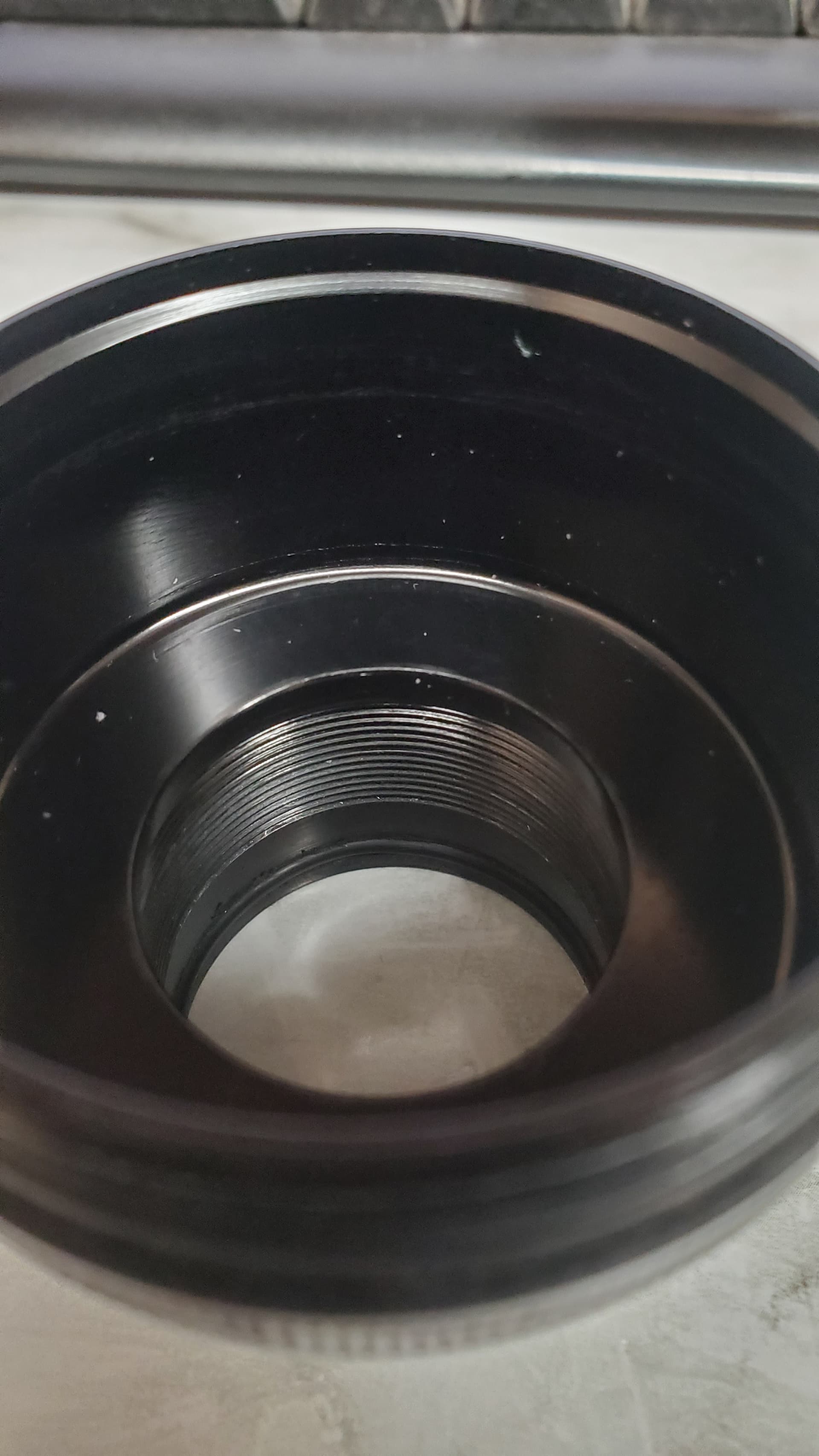

First off let me say congrats on a rare score. As far as what you will be able to get for upgrades, I don’t think my 3500 lumen will fit that light. I have an older C mag that says “patent pending” on it, that will not allow the dropin to sit down in the head all the way. There is a shelf that chokes off the the lower part of the head just above the threads.
You might be able to use the 325 lumen bulb I have, as long as you put one dummy C cell in the body so you don’t exceed the max voltage.
Mine says patented made in usa what is the difference between the one your part fits and the other? Is it just the opening in the head which is around "1.077to the batt tube? My shelf is .92 in below the rim of the head. I have one that says patented in usa with a"1.20 opening which is you c adapter for please? and thank you for responding to my post. I will switch lower heads in a heart beat I want a bright 7 C mag light. And yes to the dummy cell :wink:
