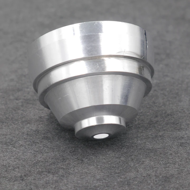

Closest looking unit I've found in AliExpress.
Cheers ^:)
http://www.kaidomain.com/p/S026934.57_8mm(D)-x-55mm(H)-OP-Aluminum-Reflector
It's this one.
Cheers :-)
but not op but smooth it seems
