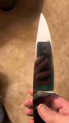

The last knife I made after polishing the 63RC MagnaCut 5 1/2” blade and stropping the edge on the final polishing grit (5000)

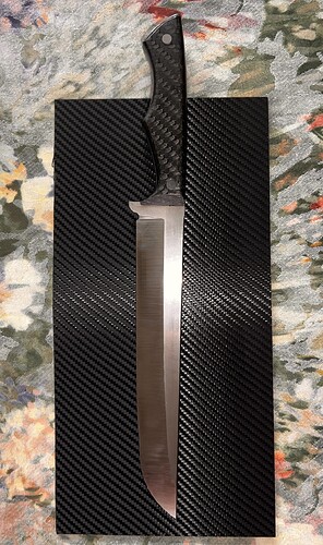

I had to buy a carbide drill bit to get the pin holes drilled…. In the annealed state! It ate cobalt band saw blades and cobalt drill bits. (Literally destroyed a brand new bandsaw blade in less than an inch of cut.)
And yes, at 8.25” the Lansky was challenged, made it, but not easily. My Katana is maintained the old school way…
