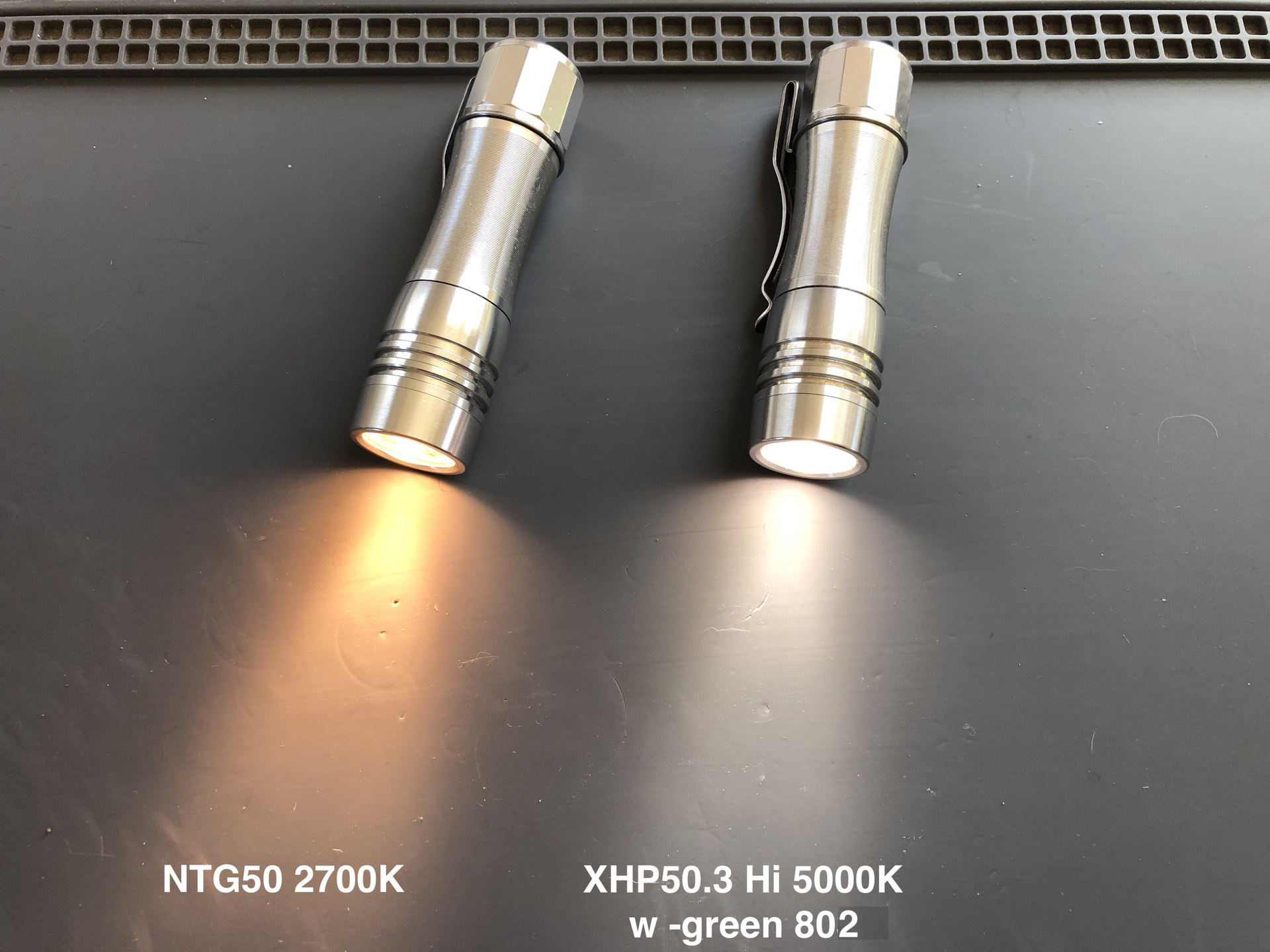

V2.5 Polished (left), V1 Raw (right):
ImPatiently waiting to hear if Jackson offers either of those two finishes, as I would like to buy one more. :wink:
