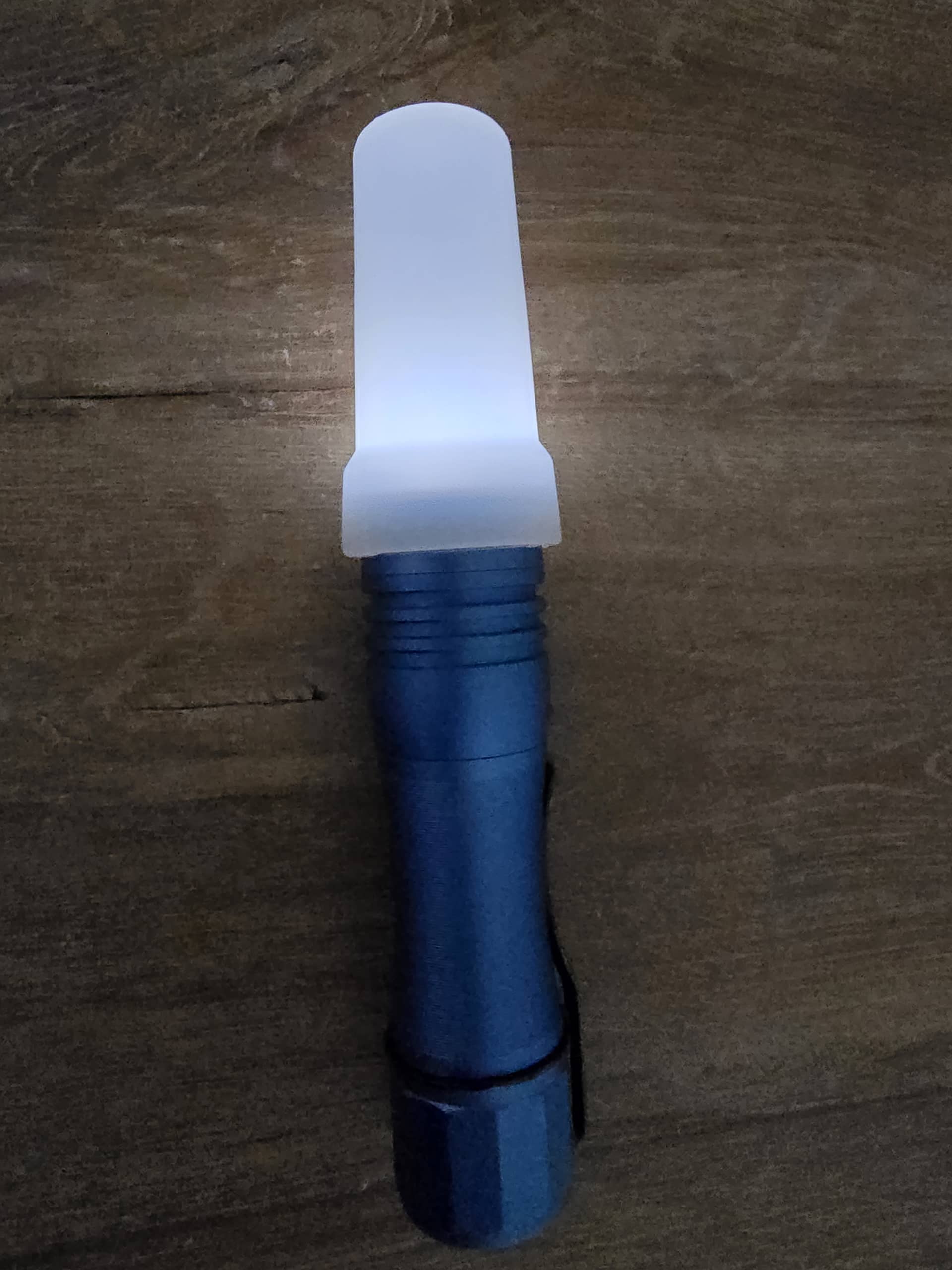

For both new lights it was the first time I loaded flashlight from Hank lineup with Nimh.
KR1AA ntg 5000k with eneloop is a great nightstand light for kid when paired with diffuser from tac 2aa

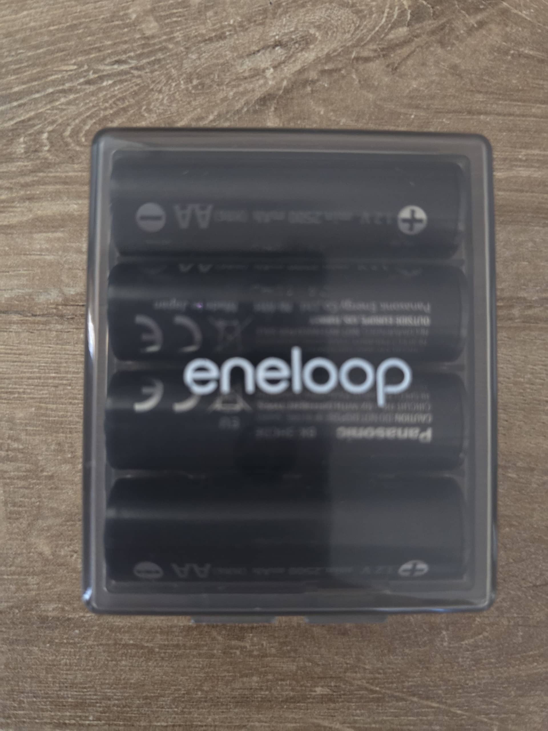

The advantage of eneloops that it safe to have a pack of them in your bag so you have 18650 capacity if you need it:

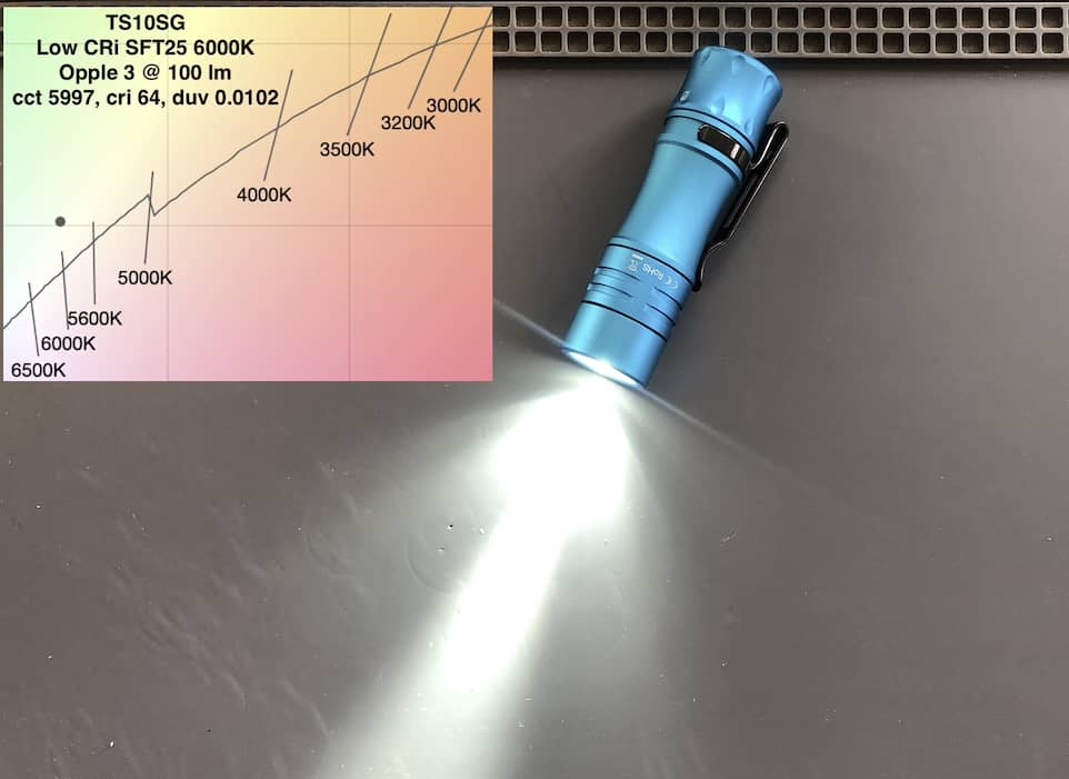

The TS10 V3 uses the same optic as the previous TS10SG, there is no other optic option
A 519a in that optic produces a floody beam, I dont know the CD per lumen
According to specs, SFT25 in TS10SG produces 13 cd/lm, but it is Low CRI with Green Tint:

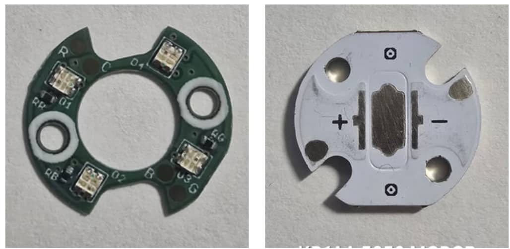

Has anyone swapped B35AM into a KR1AA? I guess there aren’t too many reasons to do it, unless you strongly prefer a neutral tint, because as far as I’m aware Hank’s KR1AA emitter options are on either end of BBL.
I’m mostly just wondering if it plays nice with the optic. I don’t think only lowering ceiling would get the current draw where you want it, right? Doesn’t a single B35 like 2.2-2.4A?
replace the stock mcpcb to fit either B35AM or Nichia 719a:

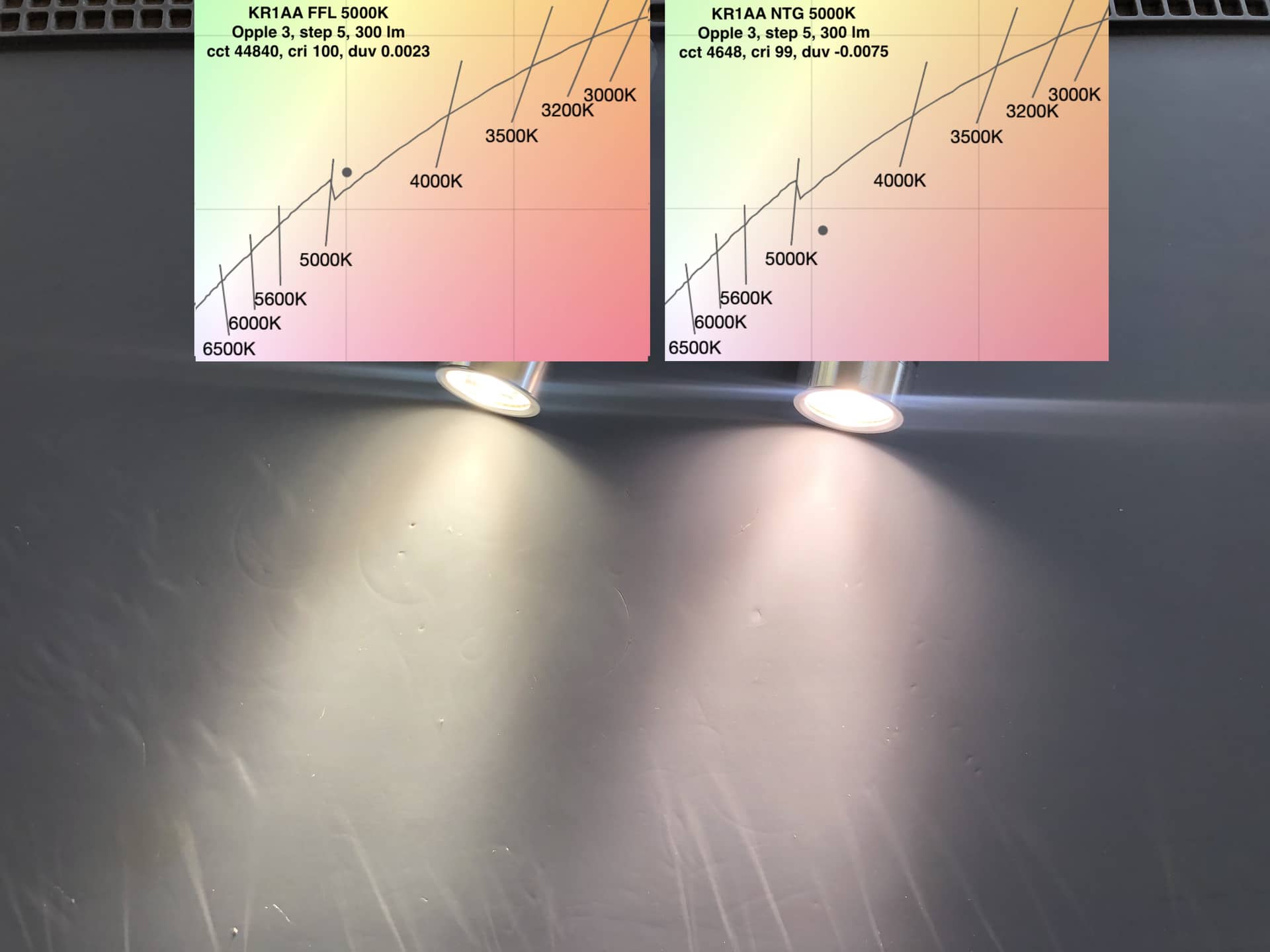

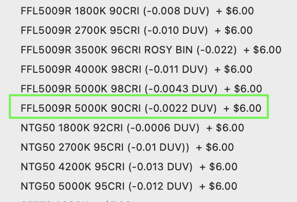

other ways to get neutral tint without changing the mcpcb:
  1. buy Jacksons neutral FFL 5000K (on left):
    (his Opple 4 DUV numbers dont match my Opple 3 test)
  2. or you could use Hanks SFT70 3000K
I really wish that Hank would offer the Nichia 719 as an option for the single-emitter lights.
I have the SFT-70 3000K in my silver KR1AA and like it. I wish there was a neutrally tinted high CRI 4000K version though.
I did not know there was a neutral version of FL5009R available, thanks.

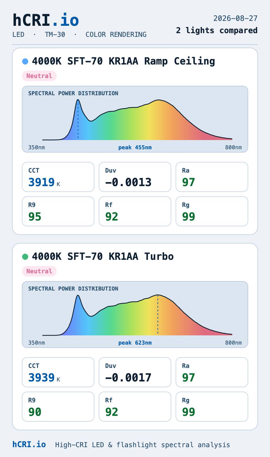

No, I would have to actually make one to take measurements. I am stocking KR1AAs to sell with B35AM and the new CRI 95 SFT-70, but I can just as easily use 719A.
Wait wut? SFT70 95 CRI? Do you have a list somewhere of what you have and what you can make?
There are now High CRI SFT70 at Kaidomain
I dont know the tint DUV.. maybe mcbob can tell you
SFT-70 (SFT-70X-W High CRI) is available in CRI 95 at 2700K, 3000K, and 4000K, with really nice neutral to mildly rosy tint. It was previously only available in high CRI at 3000K. Even the new 3000K is an improvement since what KD is stocking is two flux bins higher.
