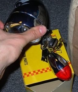

A couple years ago I got a dynamo hub for my bicycle and made a very simple led headlight out of some cheap leds from ebay and a pcb from radioshack and hooking it up to my hub. I was able to put the makeshift led light bank into an old bicycle light housing and it looks great and matches my bike. But, it’s not very bright.
I would like to replace it with something brighter but hopefully still vintage looking to match my bike. Is it feasible to hook up an XM-L T6 to my dynamo light with schottky diodes or something? Could I take the drop in out of a flashlight and mount it in an old light housing and wire it up? Or would it be more complicated than that?
Can anyone give me some pointers or ideas on how I can get a brighter light that can still be powered by my dynamo hub?
