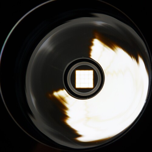

The LED has no dome and resembles a ChangDa SFP55. The 25 LED chips are arranged in a 5x5 matrix on the dark gray substrate—in a 25P configuration, resulting in a voltage rating of 3 V. White silicone resin was applied around the chips, and the phosphor was apparently applied afterward as a gel suspension.
According to the manufacturer, 55-mil Sanan chips are used.
The footprint is 110110, with an approximate size of 11x11 mm. Standard MCPCBs with this footprint should fit, but the LED is also supplied mounted on a 32 mm PCB. The thermal pad is stamped with the initials (?) “JL”, which were already present on the NBQ86 I tested earlier.
The phosphor was applied relatively evenly; only on the outer LED chips can minimal differences in the phosphor layer be detected. The particle size of the phosphor is very small, and the size of the light-emitting area is approximately 61 mm².

The beam is good. There are no complaints whatsoever, particularly in OP reflectors. There is no tint shift in the beam or corona.

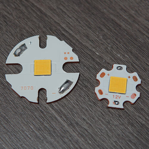

Don’t think I’m ready to start a dedicated thread so I’ll just borrow Koef’s :slightly_smiling_face:
The 7070 version is here :smiling_face_with_sunglasses:
