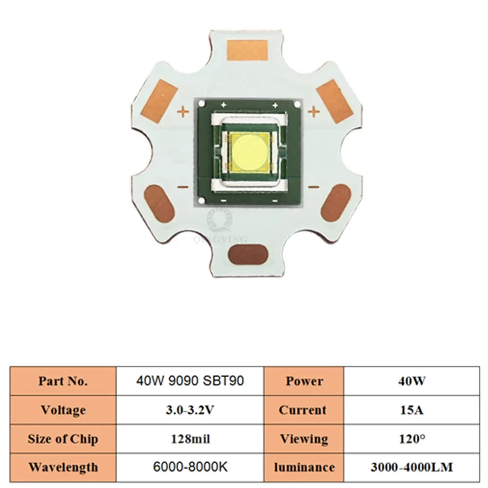

This led is marked as XHP90 but also SBT-90. A round SBT90 from official documents is not listed. XHP90 usually has a dome but they have various versions and they all look different
Has this one ever been tested?
Not as far as I know.

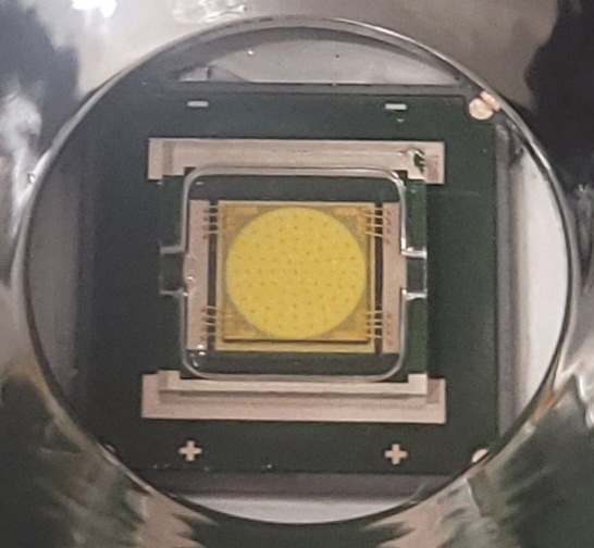

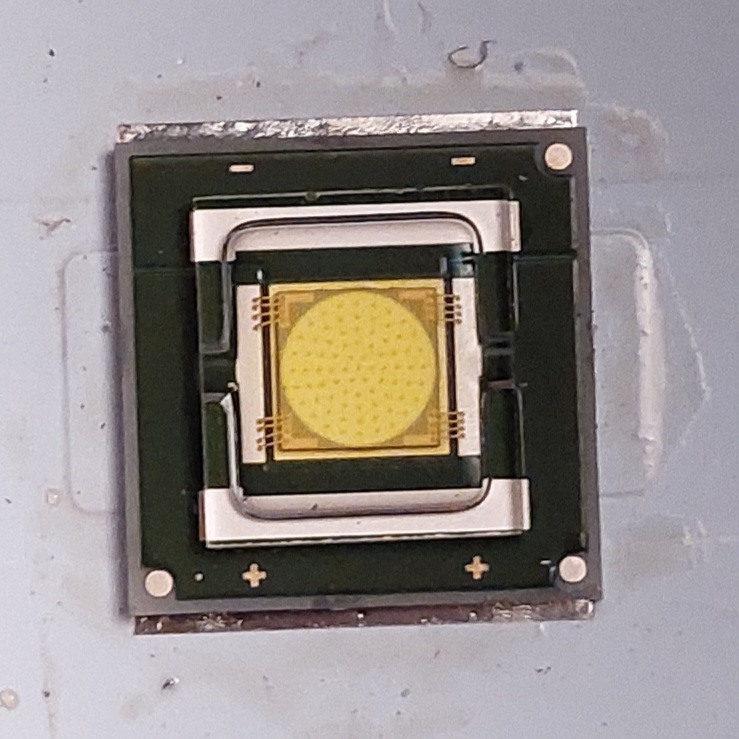

Got this round die 9090 the other day, pleasant tint, no beam artifacts.
It has some sort of glass on top of the die, kind of like the Yinding glass 5050.
Not high CRI but tint is pleasant, reminiscent of my XP-E 4A’s tint, it is more magenta than red. Duv isn’t that negative from my LM3 measurement (-0.0005), but to my eyes it definitely is rosier than that (LM3 error maybe).
As always there are bascially no specs about this LED, all I know is that it’s 4000K and 9090 footprint.
In an Amutorch ? looks identical to the “RC90” used in the Amutorch XT45 and XT60 : Amutorch XT45 RC90 review | Thrower flashlight with 3500 lumens | 1Lumen.com
Direct driven it does 2000lm at turn on.
A random youtuber calls it “Lattice Power RC90” but nothing on Latticepower website.
hmm, yeah, weird, a couple sellers have this one but indeed they don’t ship to Germany.
I got the emitter from Starfish (they also sell flashlight and hosts). But I wouldn’t be surprised if it’s same exact emitter used in the Amutorch offerings.

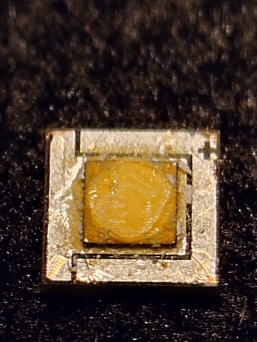

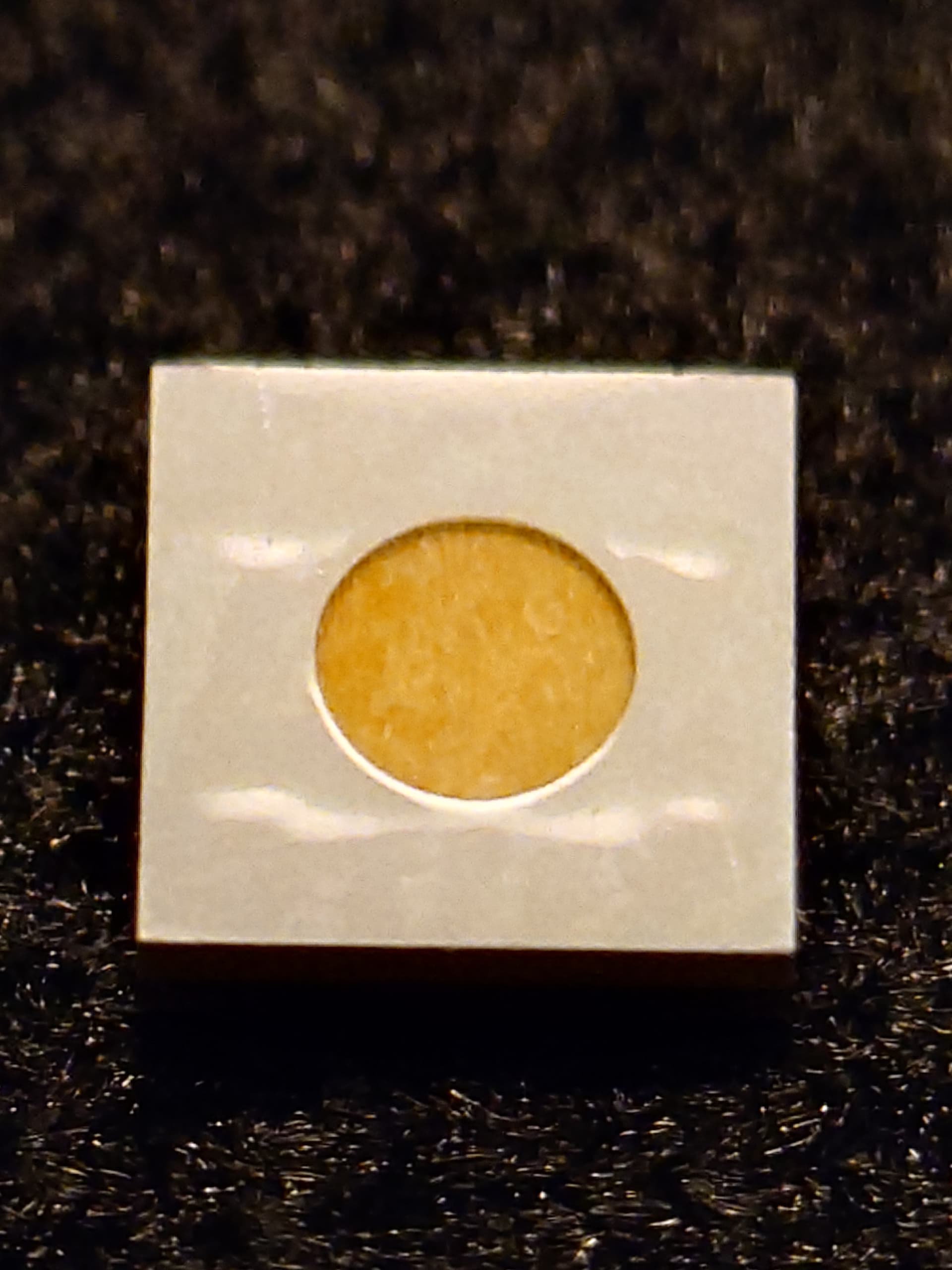

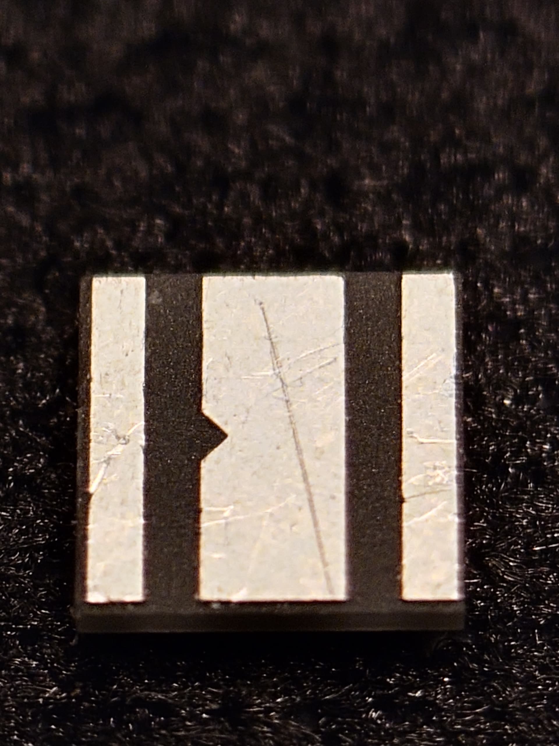

There is new HT35 round LED on Kaidomain but it’s not exactly the same as I thought it would be. Sadly after teardown it stopped working so couldn’t get it show if all square lights up or only round thing in the center. They’re 1.5$/pcs so very nice. But no datasheet as usual.
If you remove all the phosphor you should be able to see if the die is round.
Yes I did and it’s perfectly round :slight_smile:
