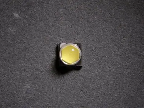

The 519A is a simple emitter. The yellow-orange light emitting surface (LES) is surrounded by white silicone with a transparent dome on top. A square marking and some type of code are located in one corner. The 519A-V1 has additional lettering, which is also the only real distinguishing feature.
Handling is easy, the silicone is relatively robust and not very sensitive, although care should always be taken when handling LEDs anyway.
A direct comparison shows that the LES of the 219 family are getting larger and larger, which increases efficiency and maximum achievable luminous flux and potentially reduces the forward voltage. The 319AT with its obscure hexagonal light surface stands out here in particular.
The footprint reveals no surprises. The contact surfaces are gold-plated. The only difference to many other LEDs is the slightly smaller contact surfaces for the anode and cathode. The thermal pad is not reduced in size.
The LES is designed like that of many other flip-chip emitters. A fine granulation runs through the luminous surface. The mixture of these very small blue and yellow dots produces the specified light color. In general, most of flip-chip style LEDs seems to have those granulated surfaces instead of plain and evenly lit ones.
Dedoming is extremely easy to do with the 519A: the dome on the LED can be removed by gently lifting it off with a fingernail. The best results are achieved as long as the LED is warm (e.g. due to previous operation with a higher operating current). This is made possible by a glass-like protective layer on the LED chip, similar to these of the Nichia 719A. No other LEDs with a similar dedoming option are known. The success rate is very high, I am not aware of any failures due to dedoming to date.
The luminous area is 7.2 mm² in size. The flip-chip design means that no bonding wires are visible; the chip is connected from the underside. Light shining through from the side is not visible, which should improve the optical properties.

Nichia has set the maximum operating parameters for the 519A very conservatively. The 519A can be overcurrent by four times the specified maximum current.
After dedoming (removal of the silicone dome), the luminous flux drops by around 20 %. However, this is accompanied by a significant increase in luminance, which considerably increases the range in the same optic. This is one of the main reasons why this is done. With the 519A, however, this also serves to adjust the tint; the red tint becomes more intense (the light becomes more ‘rosy’).

Have you experienced an LED being destroyed after dedoming (apart from the ugly beam)?
I did destroy one, but it was on purpose while trying to extract the phosphor for an experiment.
For all intents and purposes though, the emitter was unusable after a large chunk of the white silicone broke off, due to how bad the tint had become, in a reflector light at least.
I also had the glass crack two times (one was my own dedoming, the other came like that), but it seems to still be fine.

The 219F also has glass under the dome like the 519A. I found out accidentally after destroying a 5700K R9080 I had got from Simon. Unfortunately I wasn’t able to check how much the CCT and duv changes with dedoming.
