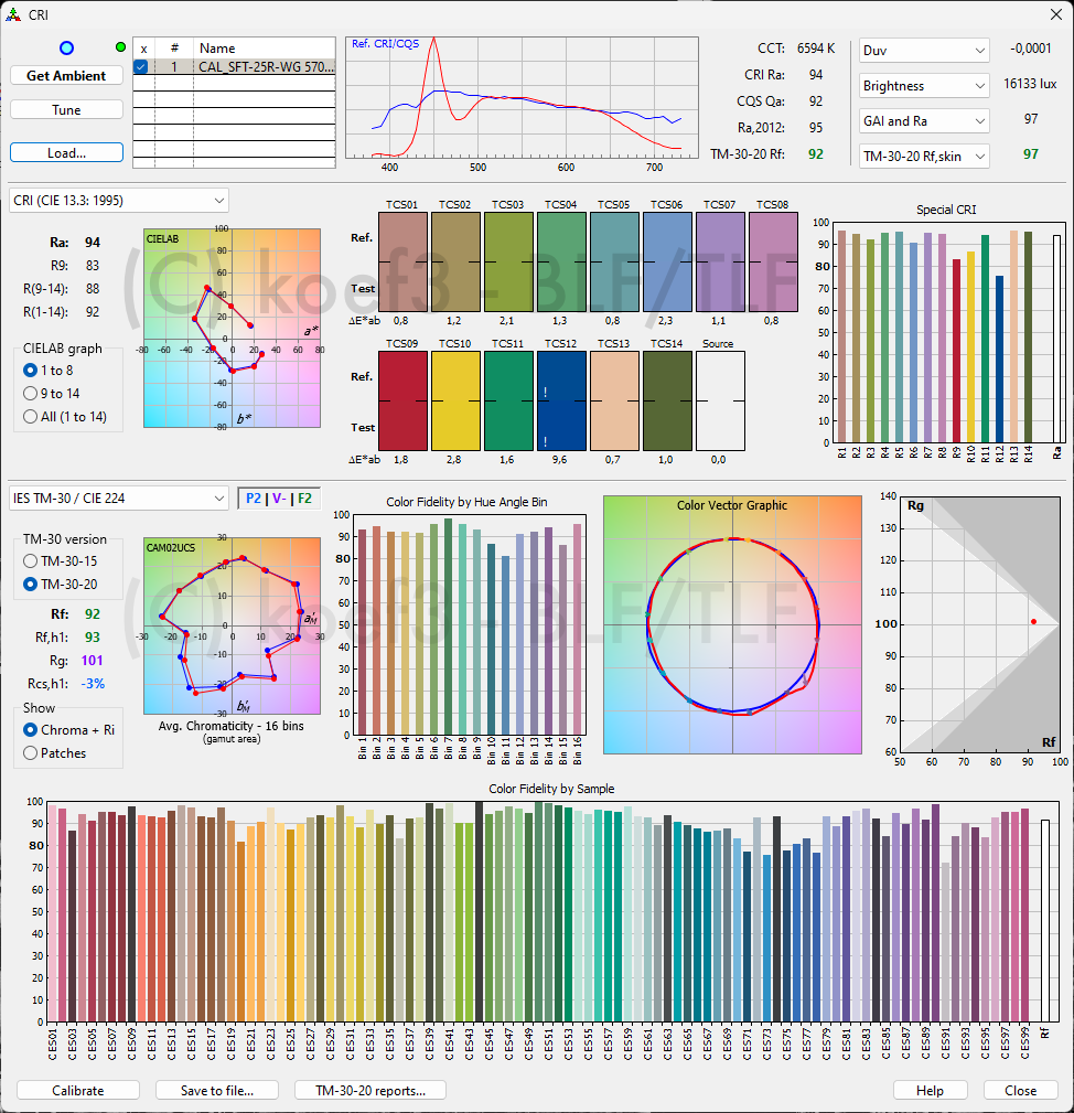

Here is the comparison chart of the F35 by Skilhunt shown, the SFT-25R-WG is in this chart.
The spectrum has no surprises, although the CCT is very high with over 6500 K. The tint is very nice with duv -0.0001.
There is no heavy tint shift with higher operating current. The beam is also nice, like known from the low CRI SFT-25R variant.

The power handling and efficacy seem excellent for this CRI class–it seems to max out at the same 8A current as the low CRI variant, just with -25% efficacy due to high CRI.

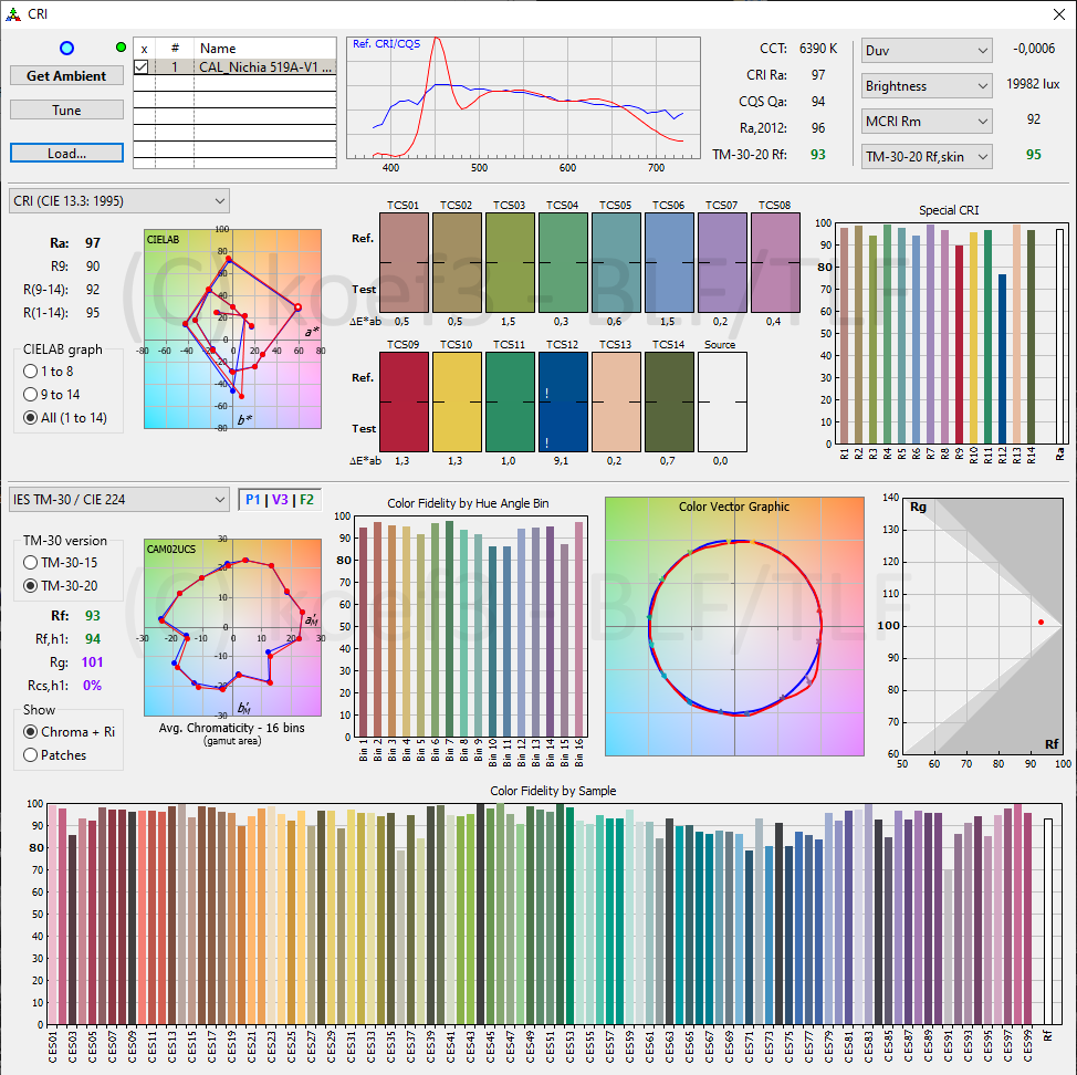

CRI looks just a tad worse (worse cyan dip and less red) than 519A 5700K (copied below from your test, for a side-by-side comparison), and the output is down -20% presumably due to the smaller and domeless LES. Still very good for a thrower though.
Interesting that your tests of high CCT high CRI emitters seem to consistently indicate higher-than-nominal CCT: your test of the 519A 5700K also ended up in the 6500K range, and the 6500K B35AM went above 7300K. I can imagine that a small change in color space makes a much bigger CCT difference in the high CCT regime, or that the blue spike perhaps introduces enough irregularity to mess with the computation.

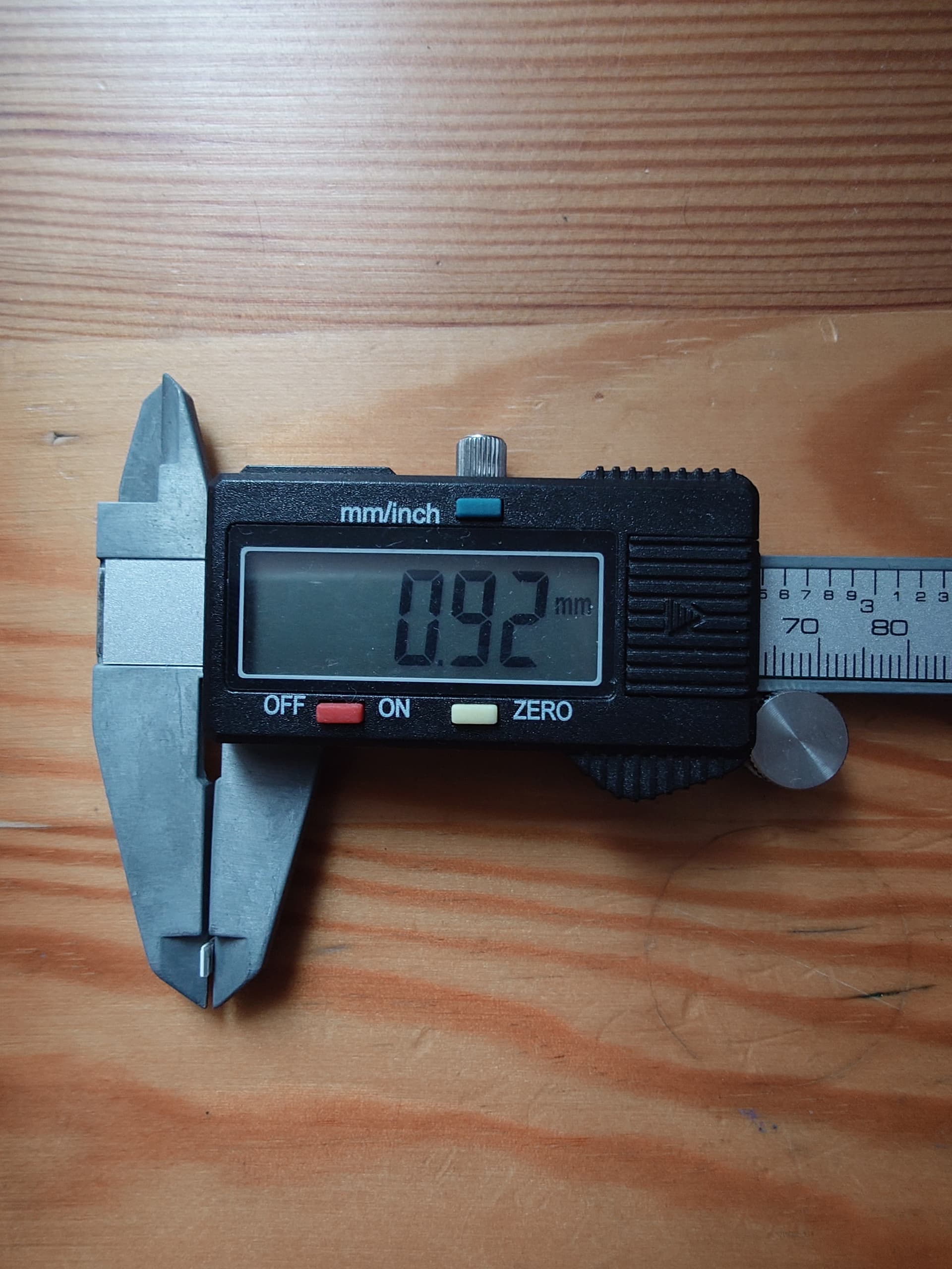

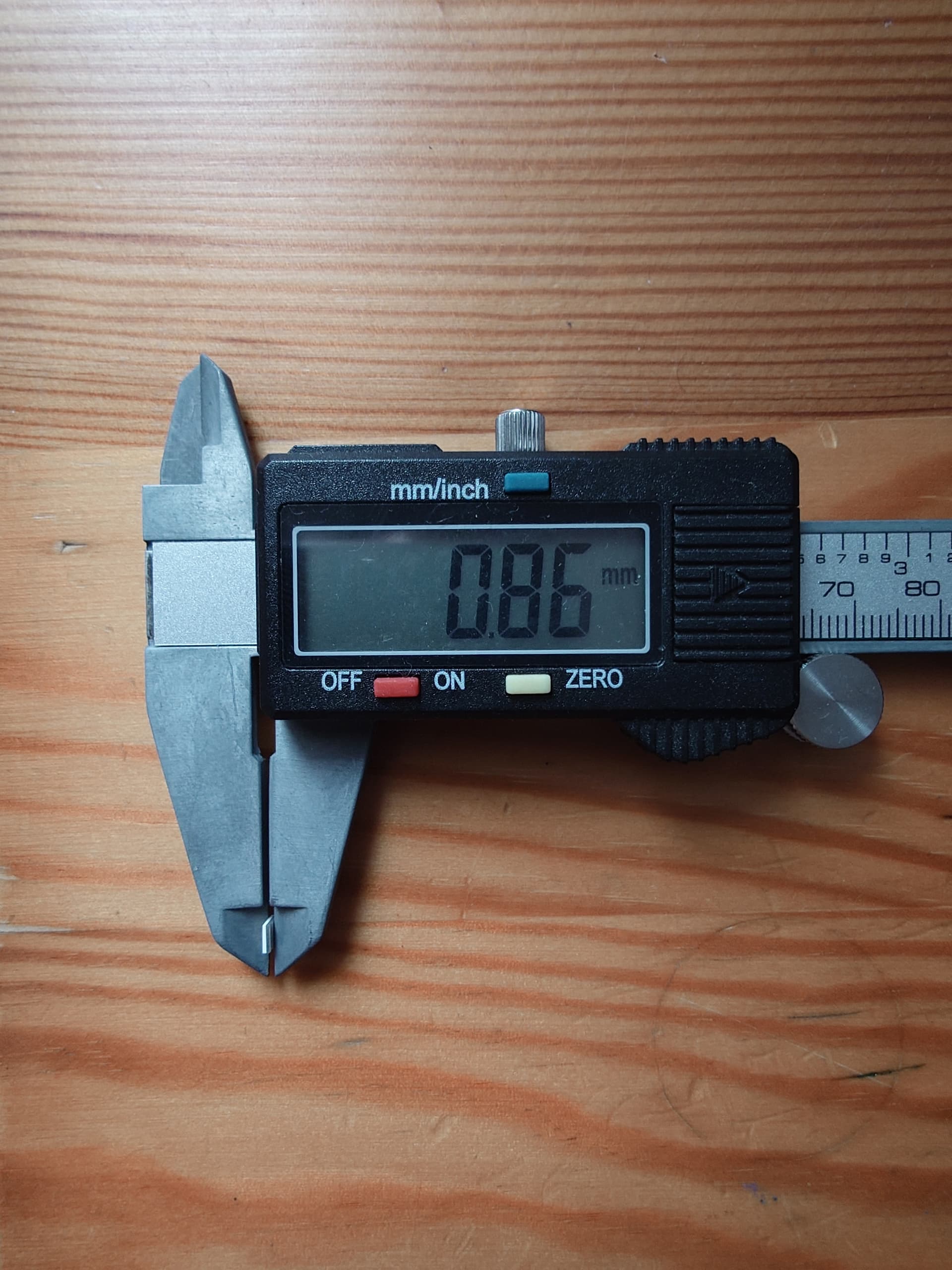

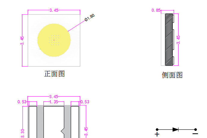

Can you compare the emitter height to the recent HT you tested (lookalike)?
I already asked you that in your post, but i guess you forgot about it.
Thx
I only have ugly green 5000K on hand so here it is
And beautiful slightly rosy HT35

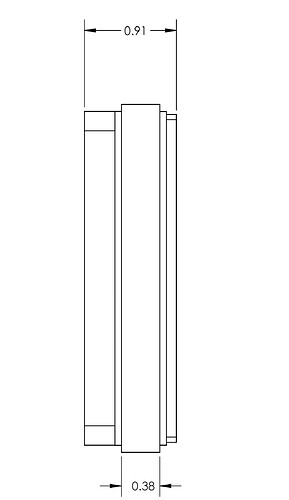

This can be confirmed by looking at Luminus datasheet
And searching the Hoptink on eg. Shoppyhub
I haven’t tested the HT35 yet.
I can compare height with F35R though. Since I am very busy at the moment I cannot fulfill every wish in time, sorry.
Is there any real proof the HT35 from KD is manufactured by Hopthink?
We are talking about Chinese made obscure emitters, everything is possible in this regard :sweat_smile:
I wrote email to Kaidomain, we will see what he answers.
I tried that before (for another obscure LED) and I got no answer from them whatsoever… hopefully they have some useful information and not only „its Chinese LED, see item description“
Yeap that’s it, SFT is “normal” height where HT(F) needs gasket trimming in order to get proper focus.thx
This focus discrepancy and need for sanding the gasket is also documented in this reddit thread.
