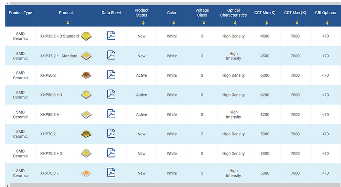

Of note, a few of these also have 3v variants that are currently available, and some that will be available soon.
Most notably, the Cree XHP50.2 emitters, so a light using an XHP emitter and 1S cells isn’t a guarantee of a boost driver, the best known example probably being the Sofirn Q8+

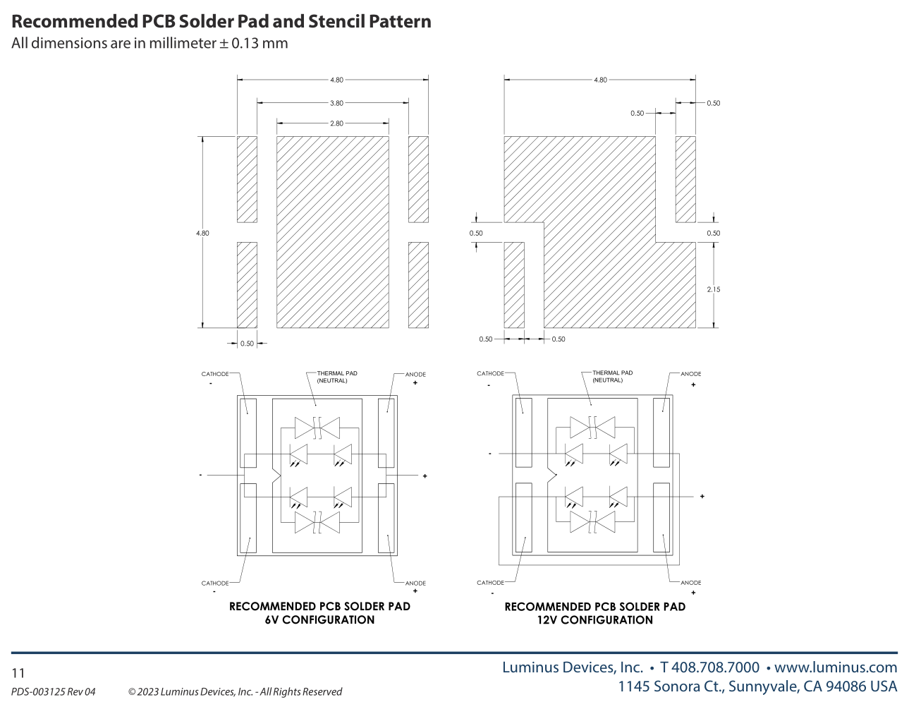

Also, the SST-70 and SFT-70 can be configured to 6v or 12v depending on the MCPCB footprint, the same as an XHP50.2/50.3
