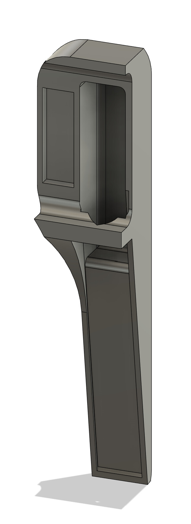

To give you a rough idea how it will look:
The left rectangle is for a magnet, the slot going down is for the LED Module, cut in half, so 12*5630 LEDs
The compartment at the top is for a battery, probably one of my many harvested E-Zig batteries, a tiny 0.6A charging circuit, a resistor and a tilt switch.
I decided to not connect the two things and just have the same thing printed twice, just mirrored. Since the charging circuit is so small and I have some space in there, it’s no big deal.
When I receive the tilt switches, I will modify the CAD drawing to make a little notch for them and then have them hopefully switch on at the same time.

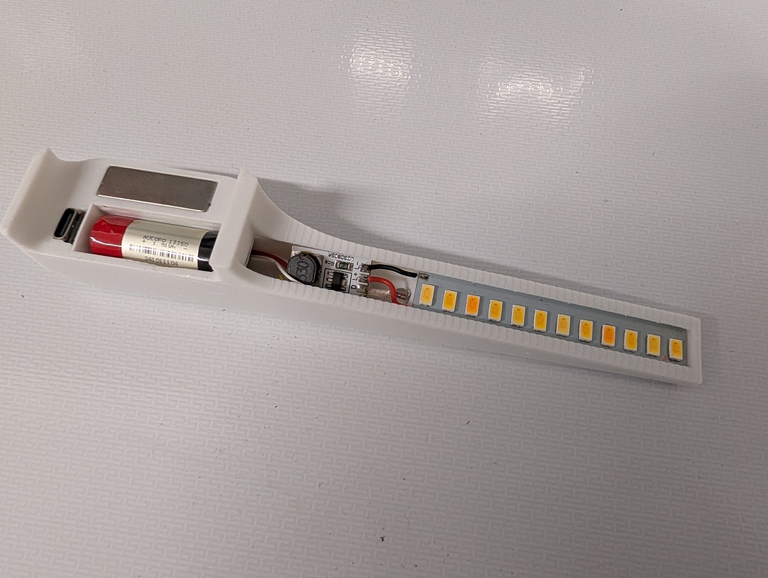

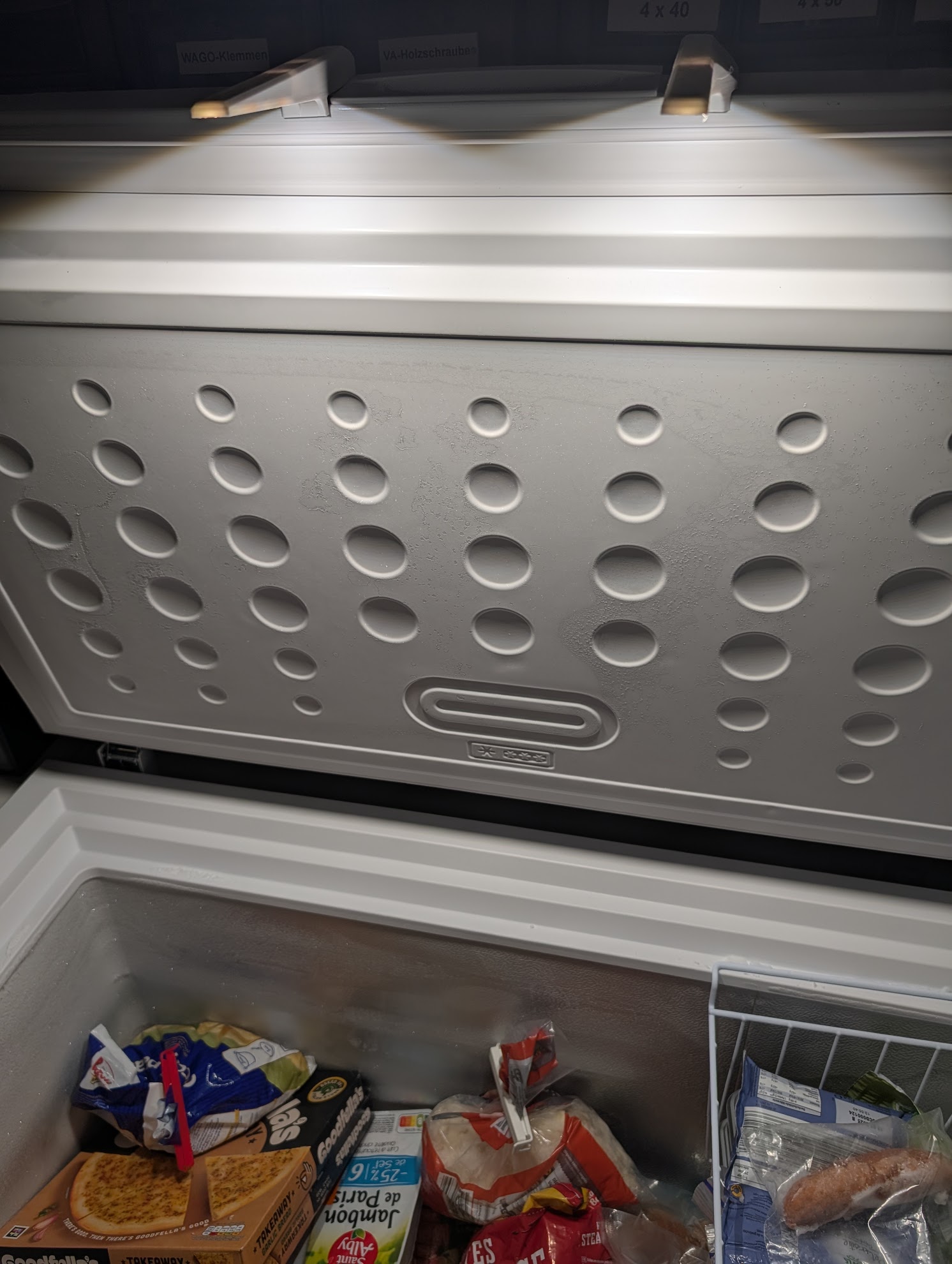

To end this, I have built the two lights yesterday and today.
Each with a 550mAh cell, a 910mA driver and a 600mA charger.
One alone would have been plenty bright enough, but it needs to be symmetric :zipper_mouth_face:
I didn’t use a resistor because it would burn around 2W of energy, and I already have very limited capacity in the tiny cells, so I don’t want to waste a lot of energy. Also I had the drivers on hand, so it was an easy decision.
