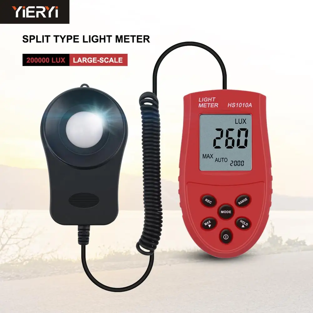

BTW, quite a few people use HS1010A which can be bought for <$10.
Really? I was also looking at those:
