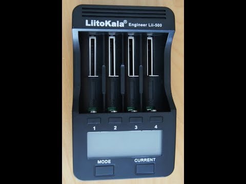

The LiiTokala Lii-500 is a 4-slot charger that accepts both lithium-ion cells as well as NiMH cells. It accepts a broad range of cell sizes, from AAA batteries up to 26650 batteries. It will also analyze cell capacity, using both charge capacity and discharge capacity. Finally, it can also function as a stand-alone USB power bank, with cells installed in it.

The LiiTokala Lii-500 is an ideal charger for most charging and analyzing needs of all your usual cells, both lithium-ion and NiMH. The main thing I like about it is its simplicity. The default settings of the charger whenever you power it on or insert a cell, are ideal for almost all your charging needs.
Standard charge rates for all 4 slots is 500mA, for all lengths and chemistries. Lithium-ion cells will charge to 4.2v, and NiMH cells will charge until they are detected as full (usually around 1.5v). When you power it on, if there are cells in it, that is the charge they will get. If you insert a cell into an empty slot while the unit is on, it will get a default charge of 500mA.
You may also very easily change the charge rate after inserting a cell or powering on the unit. Charge rates can be 300mA, 500mA, 700mA, and 1000mA. A simple press of the “Current” button changes the charge rate.
One thing I really appreciate is that this charger will fully charge very old worn-out NiMH cells, that most other chargers refuse to charge. Select the lowest charge rate for very old cells (300mA).

Each of the 4 slots on the LiiTokala Lii-500 operates independently, so you can perform different tasks (charging or analyzing) and different rates of charge for each of the slots. You can also mix different lithium-ion cells and NiMH cells together.
There are 6 buttons used to operate the unit. 4 of the buttons are used to select each slot, and they are laid out nicely under each slot. Pressing one of those buttons will display all the information about that slot. Unfortunately, there is not a way to display information about all 4 slots simultaneously.
The other 2 buttons are a Mode button and a Current button.
Pressing the Mode button cycles through the different functions: Charge, “FAST” Analyzing, and “NOR” analyzing.
Pressing the Current button selects 300mA, 500mA, 700mA, or 1000mA charge rates.
The type of cell (lithium-ion or NiMH) is determined automatically by the Lii-500. Note that only lithium-ion cells meant to charge to 4.2v should be used in this device (which is the vast majority of cells). LiFePO4 cells should not be used.
After inserting a cell, the slot will default to a Charge function with a current of 500mA. You can change this within about 10 seconds by pressing the Mode and/or Current buttons. You can also change it at any time by pressing and holding the Mode button for 2 seconds.
Note that if you load in multiple cells before you turn on the unit, if you change the default function or current, it will affect all 4 slots. This is a nice time-saver if you’re dealing with several cells at once and don’t want to use the defaults.
