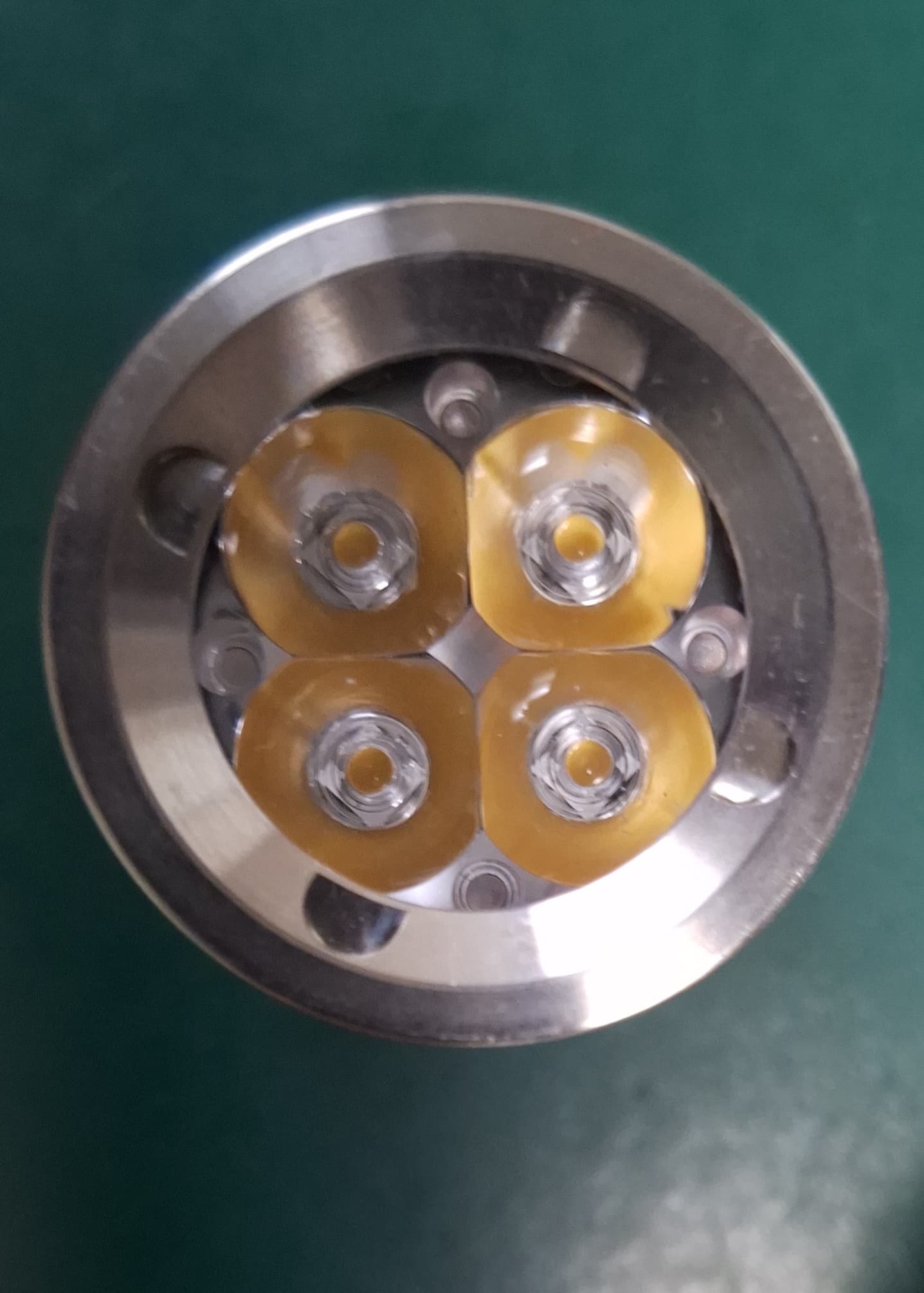

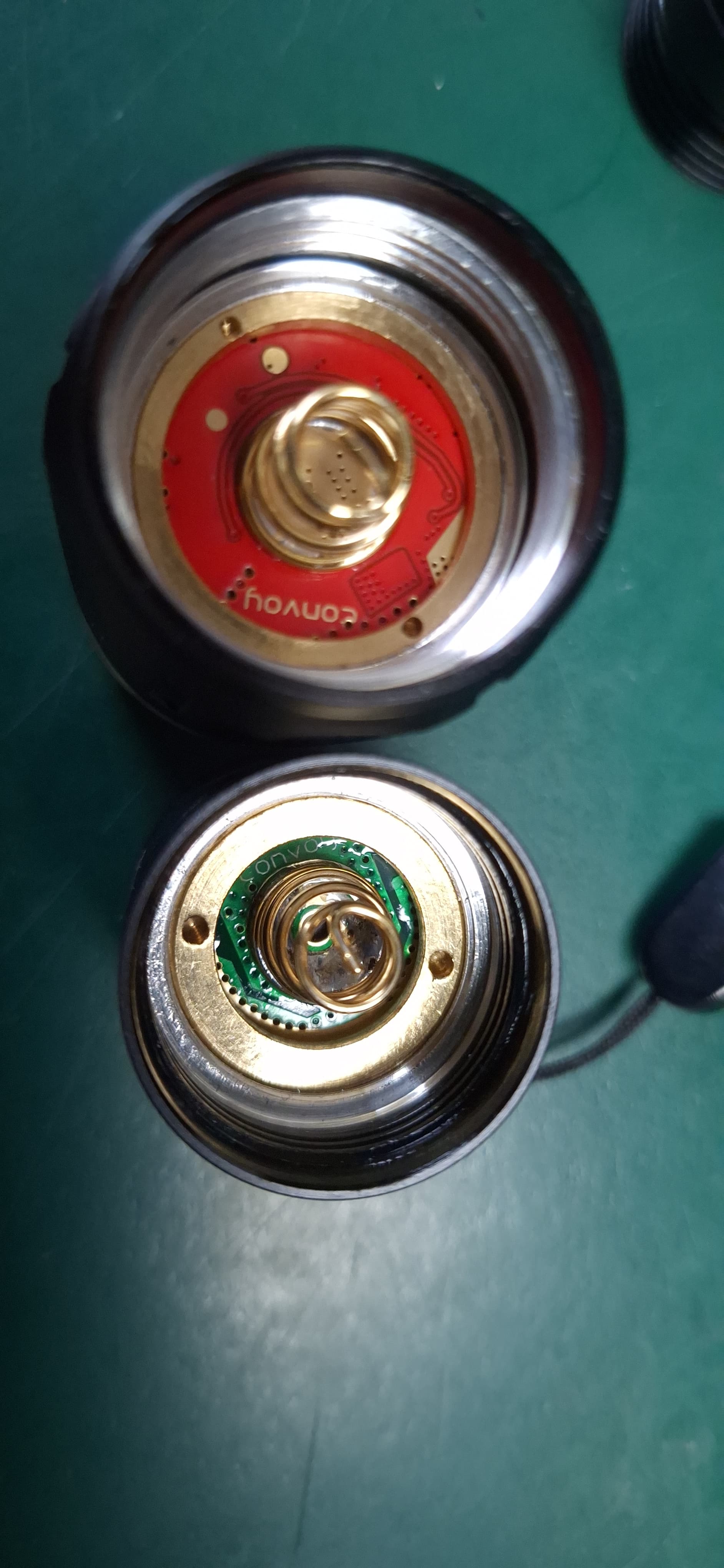

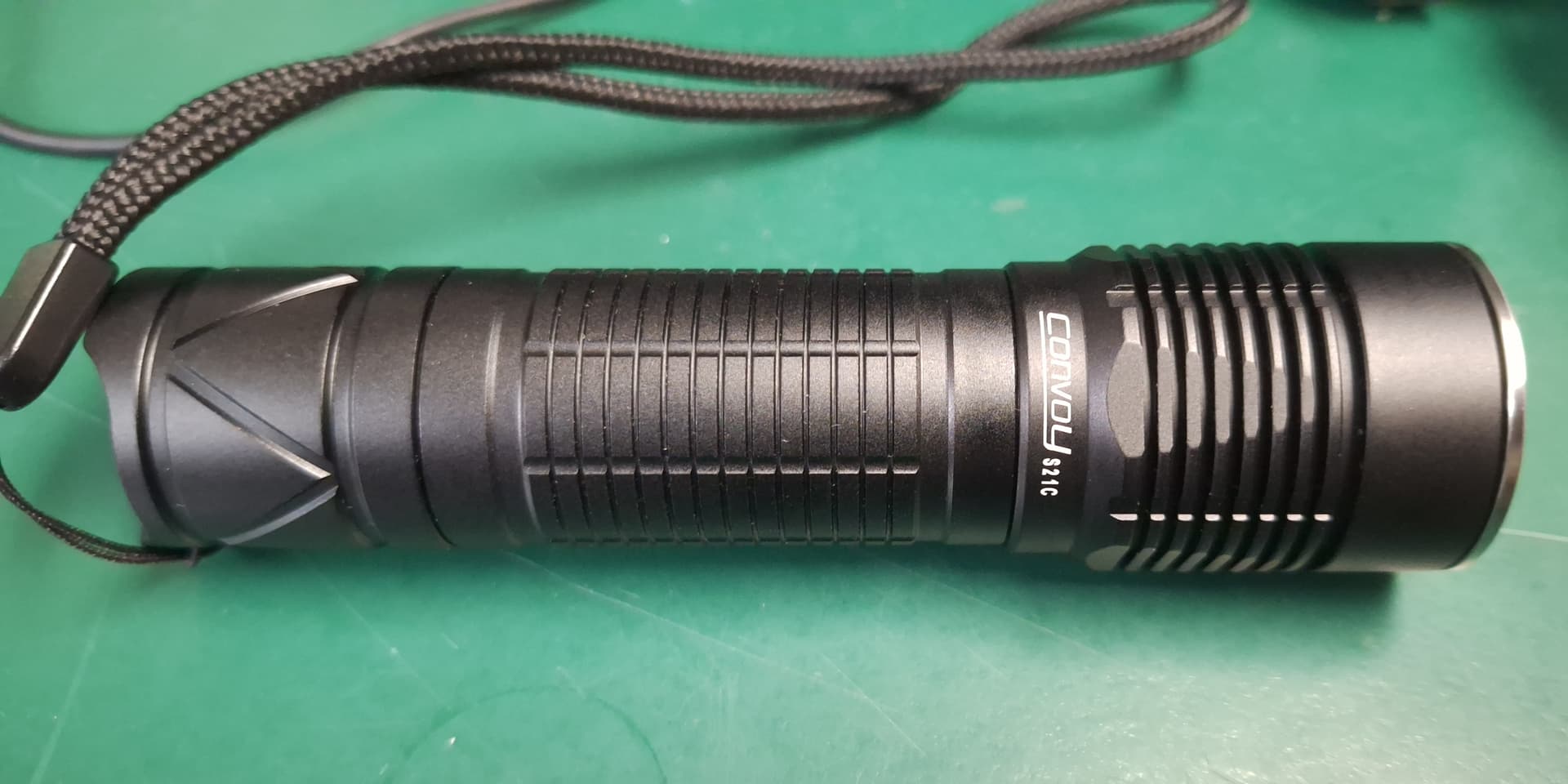

Ok so I received the Convoy S21D with the 519A 5700k tint. My impression on it? FANTASTIC! The Nichia 519A in 5700k is nearly perfect sunlight! The tint is awesome!! I love this light! Simon knows how to build a flashlight! The 8 amp version has springs on both the driver and the tail. Attaching pics.
