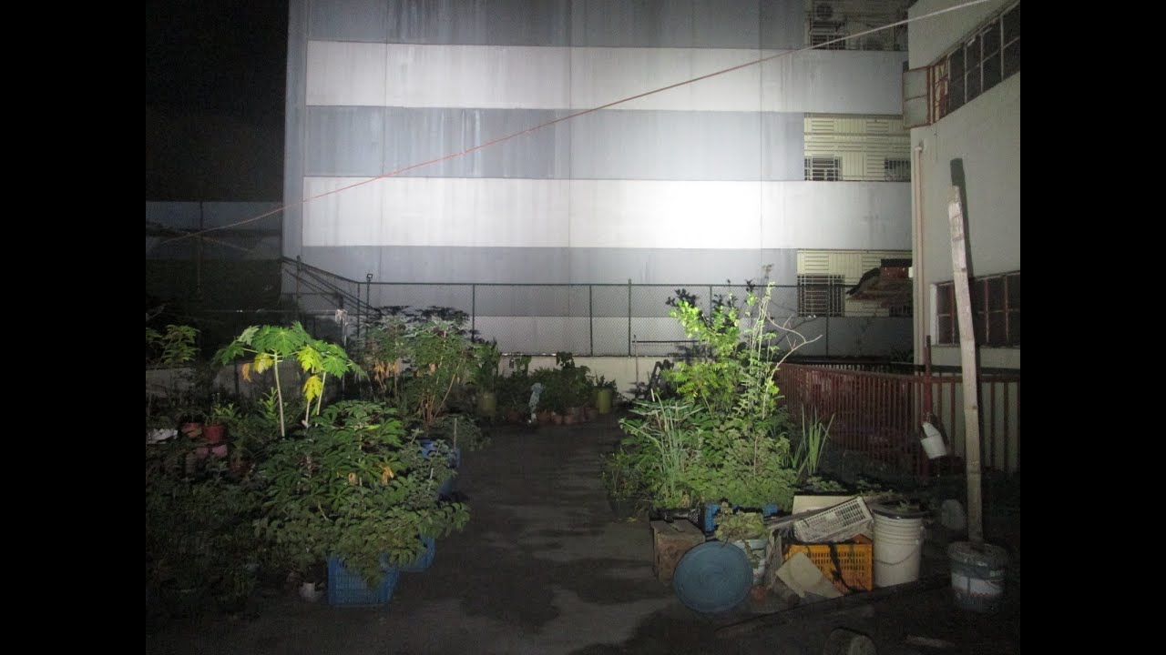

Convoy at the 3rd brightest mode out of 5 modes.

You’re welcome. You meant the MI Nextool on the left is more floody and has larger, diffuse hotspot, and the one on the right, L21a with SFT40, has a thrower beam profile, very bright in the middle and blinding you at closeup?
I believe @Hoop and someone else predicted that (and I agreed with them). SFT40 is not a good choice for what you were asking for initially, good color recognition. It is also not a good choice for close observation because of its throwy character (hotspot blinding). I have 2 lights with SFT40, like it, but this LED especially the 6000k version has among the lowest CRI (~70) of all LEDs.

Yes, exactly. The Mi Nextool is more floody with diffused hotspot. Whereas the L21A has hotspots has two zones with two different intensities which I find a little annoying. I’ll test it out in the field to see if I can live with that.
