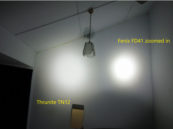

My last 3 flashlights have been disappointing.
Sofirn SC33 - a little floody and not bright enough
Convoy L21A - beam too spotty/tight
Convoy M21H - a little floody. Bright enough at 40% but lasts less than 2 hrs.
I am looking for 21700 flashlight with beam profile similar to my Fenix FD41. If you know of any, please let me know.
If you need lots of lumens for more than 2h with a single 21700 battery, the only option I know is the big Convoy M3-C, XHP 70.2 4000k.
This is actually a 26650 light but you can use an adapter for 21700 or 18650 batteries.
Here is a review of this light:
If you need more runtime, you could try the Convoy m21G, or soda can lights.
Thanks.
I don’t need a lot of lumen. I am happy with my old Fenix FD41 (zoomed in mode) on 350lumen mode. I need something with similar beam profile and a bit more lumen but with a 21700.
