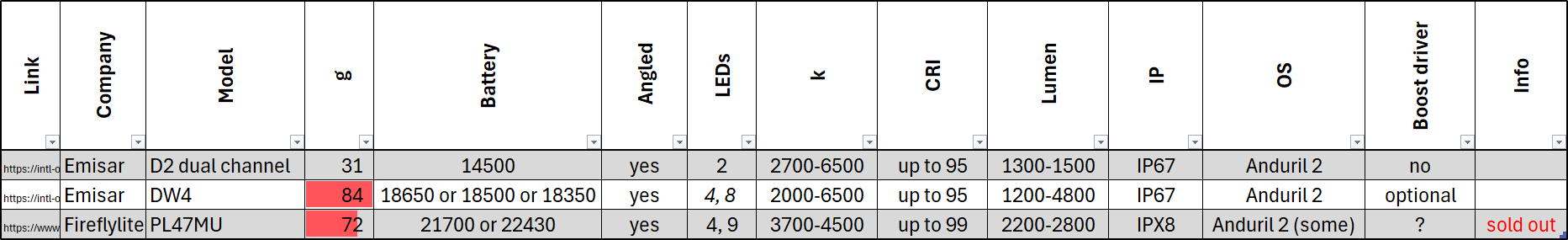

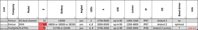

So far, I have only found 3 models:
  • Emisar D2 dual channel
  • Emisar DW4
  • Fireflylite PL47MU
