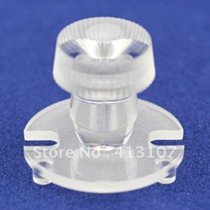

Anyone know a source for lantern optic ?
360 degree side emitter lens

No, but what LED? There are lots of (non HB) SMD side emitting LED’s out there.

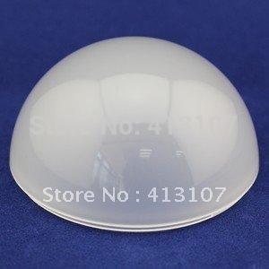

Also Hank (user name Hank, not hank from I.O.) recently posted a dome’d optic he found that looks like it should be an extremely wide beam.
You might be able to find a source for the remote phosphor domes: http://www.futurelightingsolutions.com/en/Technologies/Semiconductors/Optoelectronics/Accessories—-LED—-Optoelectronics/Pages/4013327-CL-930-CAN30-PC.aspx?ManufacturerName=INTEMATIX&isFLS=true&IM=0 but then you could just buy a complete and thoroughly engineered GE lantern for $20.

Im looking for optic to use with power leds like XML/XPG

http://www.fraensrl.com/prodinfo.html
Scroll down and look for 'Side Emitting Lens' in the Type column.
Interesting company, thanks for the link! I see that there is a colour mixing 36mm optic for the XM-L colour, narrow, medium and wide. Cereal, do you hear that?!
It could fit the Supfire L5. So now is the question, where are they sold?
