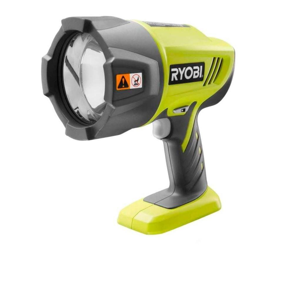

I have a Ryobi P716 18V Xenon Hi-Beam flood light and I’d like to replace the bulb with a LED if possible. The HID xenon bulb is rated 35W, 4300 K, and 2800 Lumens. Does anyone have a recommendation?

This line of reasoning doesn’t give you the full picture: it may (or may not) be true that you can find a replacement LED that is more efficient than the HID, but LEDs require heatsinking while HIDs require none. This is the reason for the above remark:
Also:
  • HID drivers are completely different in operating principle from LED drivers–you’d have to rip the old driver out and get a new one in.
  • The reflector for the HID bulb (an approximately uniform emitter) doesn’t have the right shape to accommodate an LED (a surface-mounted, approximately Lambertian emitter). You’d have to cut off everything from the focal plane to the vertex.
In combination with the fact that the light was built with no heatsinking in mind for the emitter, it’s best to leave the light and get a separate LED light if you wish.
Nowadays LED lights are catching up and performing on par, in both intensity and output, with almost all HID lights–most of them simply don’t have a reflector that is precise enough to correctly focus the arc. The only rare exceptions are dedicated thrower HIDs with specialized high-intensity (low-output) bulbs and high-precision reflectors (e.g., Maxabeam), which easily run you a couple thousands of $$$.
Use a compatible HID bulb, get the PCL661B 18V ONE+ LED SPOTLIGHT, or put a bit of effort into gutting the HID ballast + tricking out the DRM on some ONE+ batteries + inserting a LED/driver.

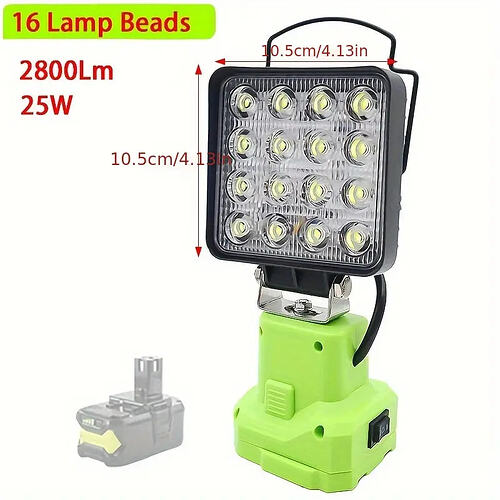

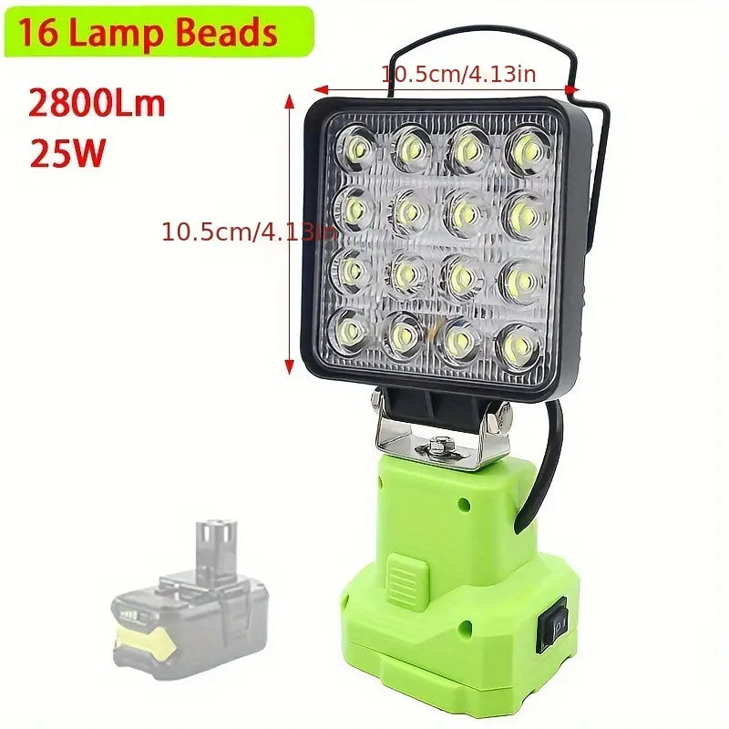

And if you want a LED light to work with your battery system consider getting one of this style of lights:
Aftermarket automotive off road lights fitted to a Battery adapter.
or get fancy and DIY fitt a 12-24V automotive light to this:
