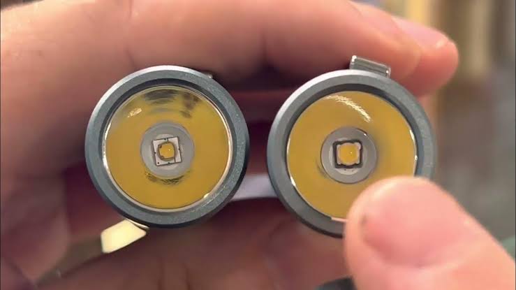

I don’t think that’s an XP-G. It looks like maybe a Samsung LH351B.
It doesn’t matter very much. At the levels of electrical power that would produce 325lm from an LH351B, XP-G, or similar, a different LED will not produce enough of an output increase to care about; you might not even be able to tell a difference without instruments. You can change the beam profile, color temperature, tint, or color rendering index with a different LED, but it will not significantly effect output.

It’s cheap and very, very good: 519A LED , high CRI R9080 - Convoy flashlight
Measure your board, but it looks like the 16mm version could fit with no big modifications.
