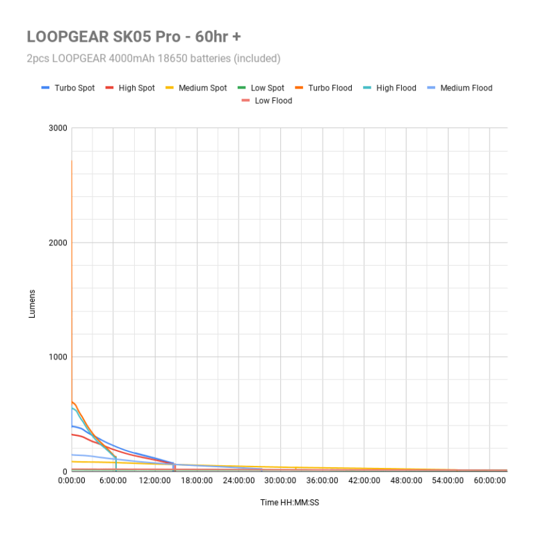

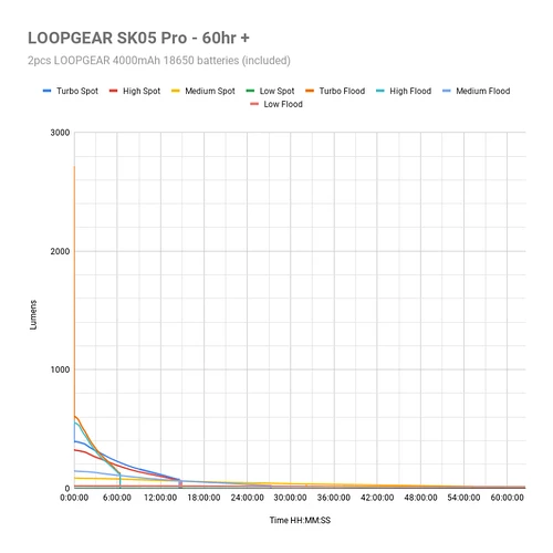

1lumen just posted a review on the pro version.
The output starts dropping in less than an hour after starting not to mention it’s not meeting the stated output.
I thought at least the pro version is supposed to have a buck driver?
And where did you get the idea that there is no buck? Maybe the driver is buck+ fet, buck for ~300-400lm, fet +400lm

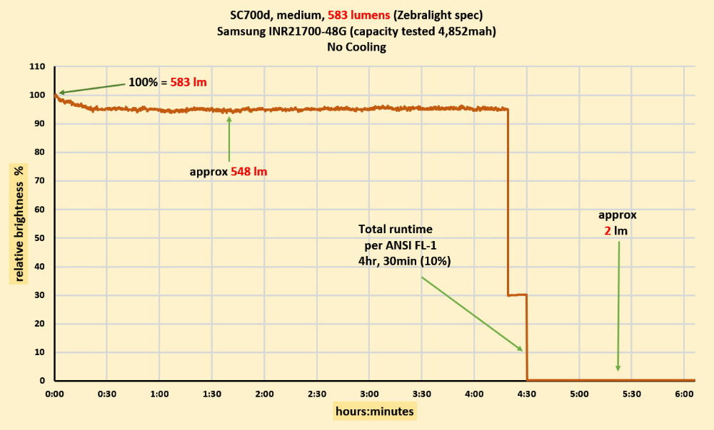

The fact that it cannot hold the brightness like my zebra light
Sc700 with a 5000 mah capacity cell can hold 500 lumens for 4 hours with no dimming
Sk05 with 8000 mah should be able to do roughly 6-7 hours steady at 400-500 lumens and yet it starts dimming in almost less than an hour
Just two hours later it’s half the brightness and yet it started at a lower brightness than the zebra
But the high spot of 320lm looks well regulated :smiley:
No dimming
It is an insult that it only maintains 300 sustained lumens in the spot, totally embarrassing, I would say you could even call it a scam.
