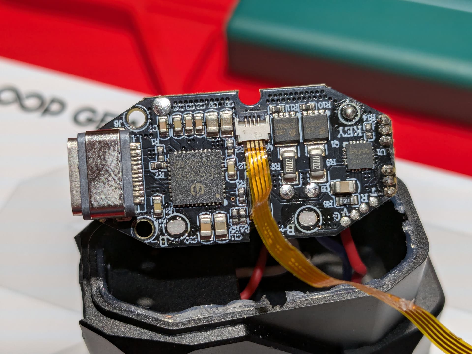

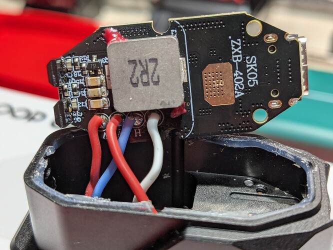

Does this PRO version have a buck/boost circuit of a just a FET one ?

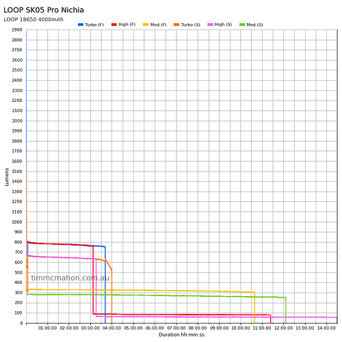

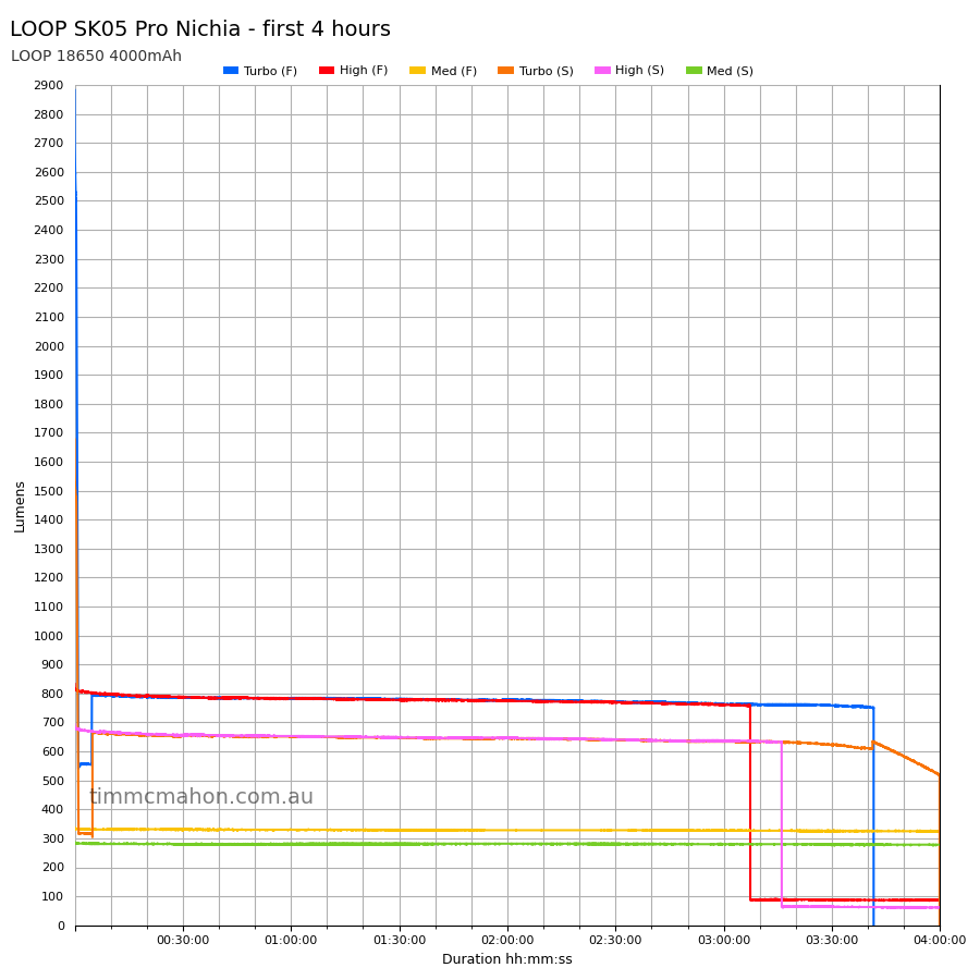

Also I still don’t understand how 8000 mah at 500-600 lumens flood can only do 3 hours. Should it not be able to do twice that? Is only one battery driving one side of the light or something? It’s not using all 8000 mah?
I’m doing runtime tests of the SK05 Pro MAO (high performance version) this week.
I finished runtime tests of the updated SK05 Pro (Nichia version). Here are some graphs:
I would guess that it’s buck due to having an input with two 4.2V 18650 cells connected in parallel and three LEDs for the floodlight connected in parallel with a forward voltage of about 3V.

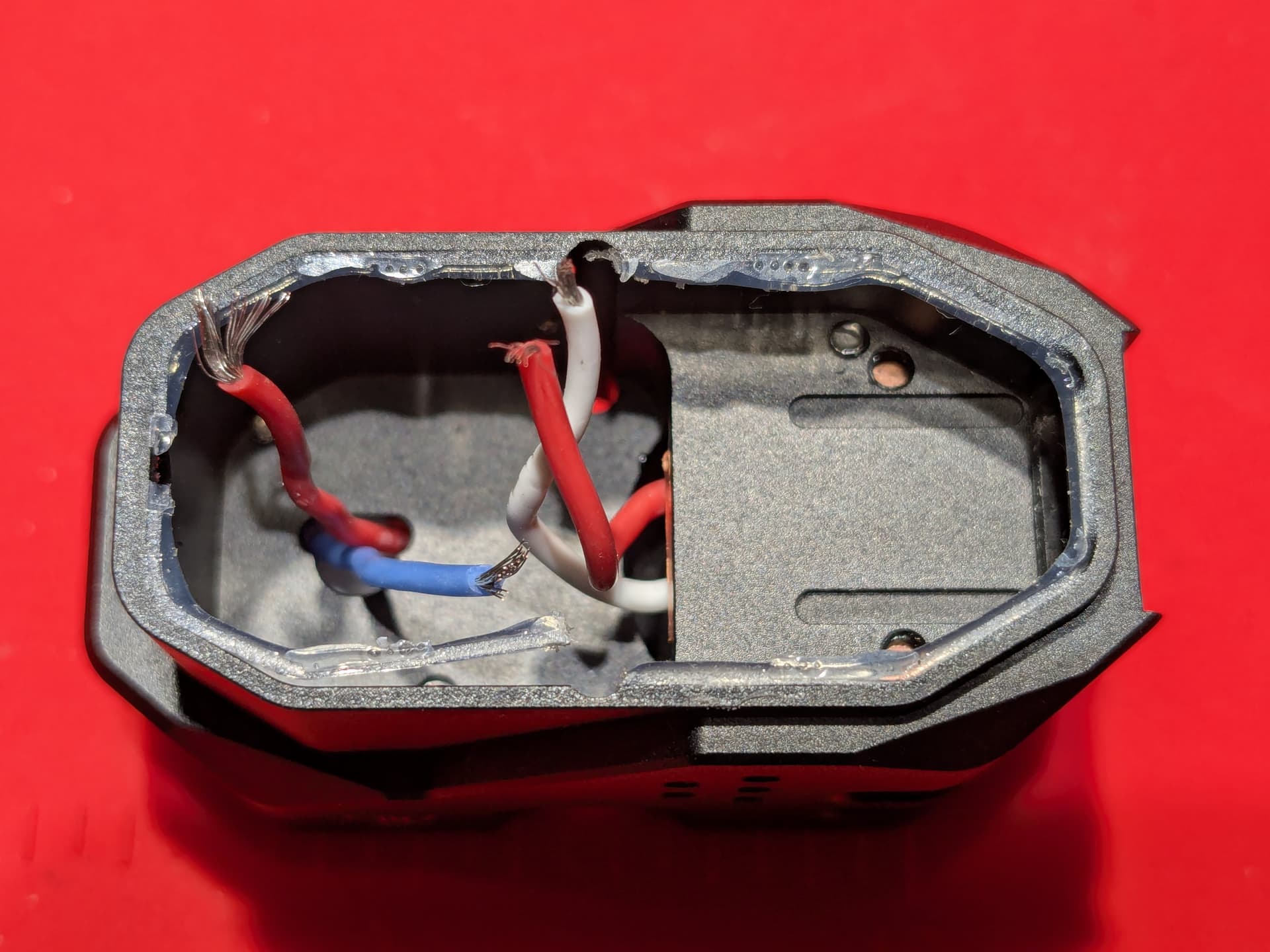

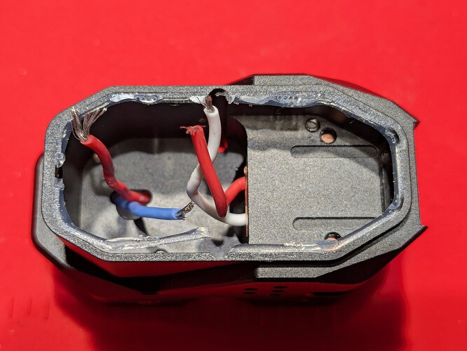

Here are some teardown photos of the original SK05:
