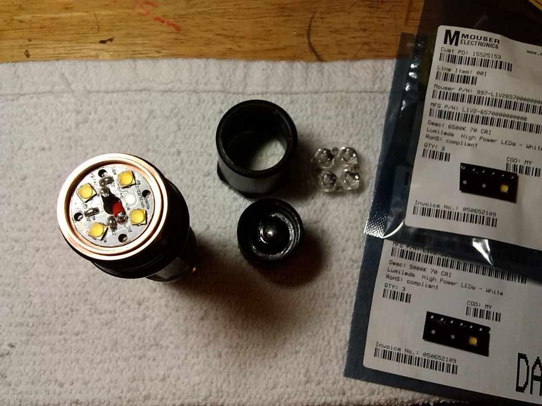

Well used my last kiriba-ru P60 Quad copper pill. This is how to wake up an old Surefire 6P that was bored and hone to fit a VTC5A and press fit the copper P60 using these new V2 emitters. I mixed 2 5000k and 2 6500k to blend tints, well the output and tint are outstanding!
The Z59 tail cap is stripped and modded with a 10amp KAN9 Fwd Click switch 18awg bypass on one of Blueās springs. Z41 bezel with double coated AR lens. Mtn. Guppydrv 3 FET+1 that the FET was changed to an Infineon FET 18awg Leads. Mtn. Quad Copper mcpcb Lumileds V2 6500k and V2 5000k emitters.
4500lm+ out of the Old Surefire 6P It was worth all the hours of hand fitting and polishing the pill/host for a nice smooth press fit, no need to copper wrap for heat transfer.
Canāt remember how many of these P60 pills I used of kiriba-ruās, they are outstanding and Iām going to need 3 more when they are readyā¦ thanks my man!
