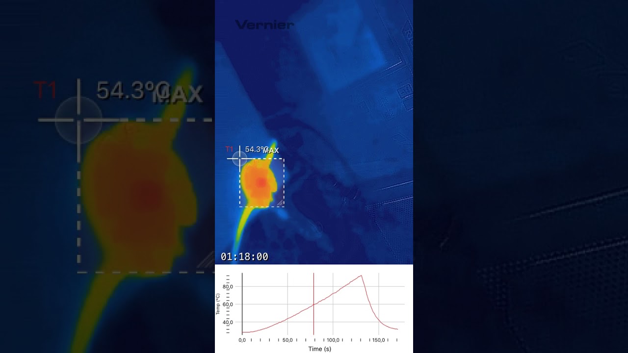

The thermal interface is very good just like Lumileds claims. Here’s a thermal video which shows that the temperature difference between the emitter and MCPCB is very small. You can barely see any difference in color.
Current increases from 0 to 5 amps in 200mA increments every 5 seconds.
Difference between emitter and MCPCB
Also Fv up to 5A created during the automated test.
