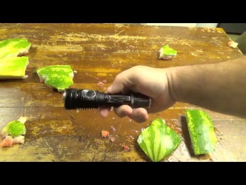

Third, the videos embedded here were shot after three weeks of constant EDCing and the TD16 has been EDCed by me for over five weeks as of this writing. Concerning the videos, there are short and long reviews. The short one is a "Just the facts, mam." review with very little opinion offered up by me whereas the second, longer vid is all that plus me at my opinionated best, or worst, depending about how you fell about me and my opinions. The third is just me smashing some watermelons with the light.
It was coming right at me!
Expect the high production values and special special effects that I'm known for and much more. I really out did myself this time. yt
LOL, don't get your hopes up.

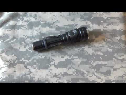

The 1000 lm Lumintop TD16 is a full sized tactical light running on either an 18650 cell or two cr123a primaries with a working voltage window between 2.8 and 8.4 volts. In theory, you could run two 16340 cells without damaging the light. My sample utilizes the Cree XM-L2 U2 emitter and has a smooth reflector. The reflector is a thing of beauty. It is also available with an XML-Hi emitter at a reduced High lumens of 920.
There are six modes altogether, but three are hidden. Your three standard modes are High (1000lm for 1.5 hours), Medium (220lm for 6 hours), and Low (35lm for 40 hours). Output and run times are the manufacture's; I did not test any of that myself.

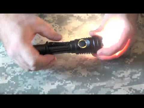

This is a duel switch light. On/off is accomplished via the rear forward clicky switch. The FC switch allows for momentary or constant on. Mode changes are handled by the side switch. So too are the accessing of the hidden modes.
In practice, the UI is really quite simple. Once the light is on, you can cycle through the modes by quick pressing the side button. At any time, a long click will bring you to the hidden modes, which are cycled through the same as the regular modes; i.e., with quick press. A long press will bring you back to the standard mode when you are ready.
Honestly, the UI is simple enough that you could figure it out in sixty seconds without reading the instructions. Also of note is the fact that the directions are short, sweet, and easy to follow; very nicely done Lumintop.
The three hidden modes are all at 1000lm. There is everyone's favorite, Strobe, a Fast Beacon, where the light flashes every other second, and a Slow Beacon, where the light flashes once every four seconds. There is mode memory and when you cycle through the main modes you progress from lower to higher modes until it repeats.
