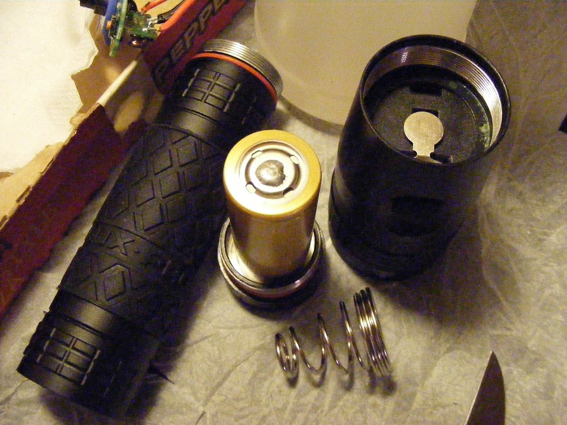

The tear down
The reflector and lens is plastic, the lens is held in place by a threaded ring. I have also seen that used in the Defiant 3D light from last year.
That is a good sized pill and the driver is secured in place with a threaded ring.
Lots of thread to make good thermal contact between the pill and the head of the flashlight. BTW, all threads were lubed or had thermal paste on them.
The pill is solid for good heat transfer from the star. Unfortunately the driver is potted. That compound is rock hard and I don’t think it could ever be removed without destroying the components underneath. Maybe the part # of the board can give us a clue as to what it really is. I know this, there is an inductor underneath all of that. I can see parts of it protruding from the edges.
The star with the XP-G2 LED. To me it looks like too much thermal compound was used. It is soft and I will remove the star and fix that later.
The plastic reflector and the centering ring.
I tested the tailcap current with the supplied Alkalines and got 2.05A on high, 0.45A on low. I was worried that this light wouldn’t work with NiMH but it turns out that is not a problem. In fact I measured the same exact tailcap current with them. In fact even at a 3.6V partially depleted Li-Ion cell gave the same tailcap reading. Lastly, running the light on just 1 NiMH cell, I measured a tailcap current of 1.82A and there was a very decent amount of light coming out of it.

Definitely a boost driver

Great News! dchomak was right. There is plenty of room for two 26650 cells with a shorter tail spring. You might be able to use the stock spring. Seems like it would be very tight and I prefer copper dome springs instead. This opens up a lot of possibilities. I think I will go with a bigger emitter in mine. Probably XM-L2 with a buck driver.
It's almost like the designer had us in mind. There is a pocket in the tail cap that gives plenty of room for that. Check out the unprotected KK sitting in the cap below.

Yes, I left out 2 pieces of important information. The driver OD is 20mm as is the star.
