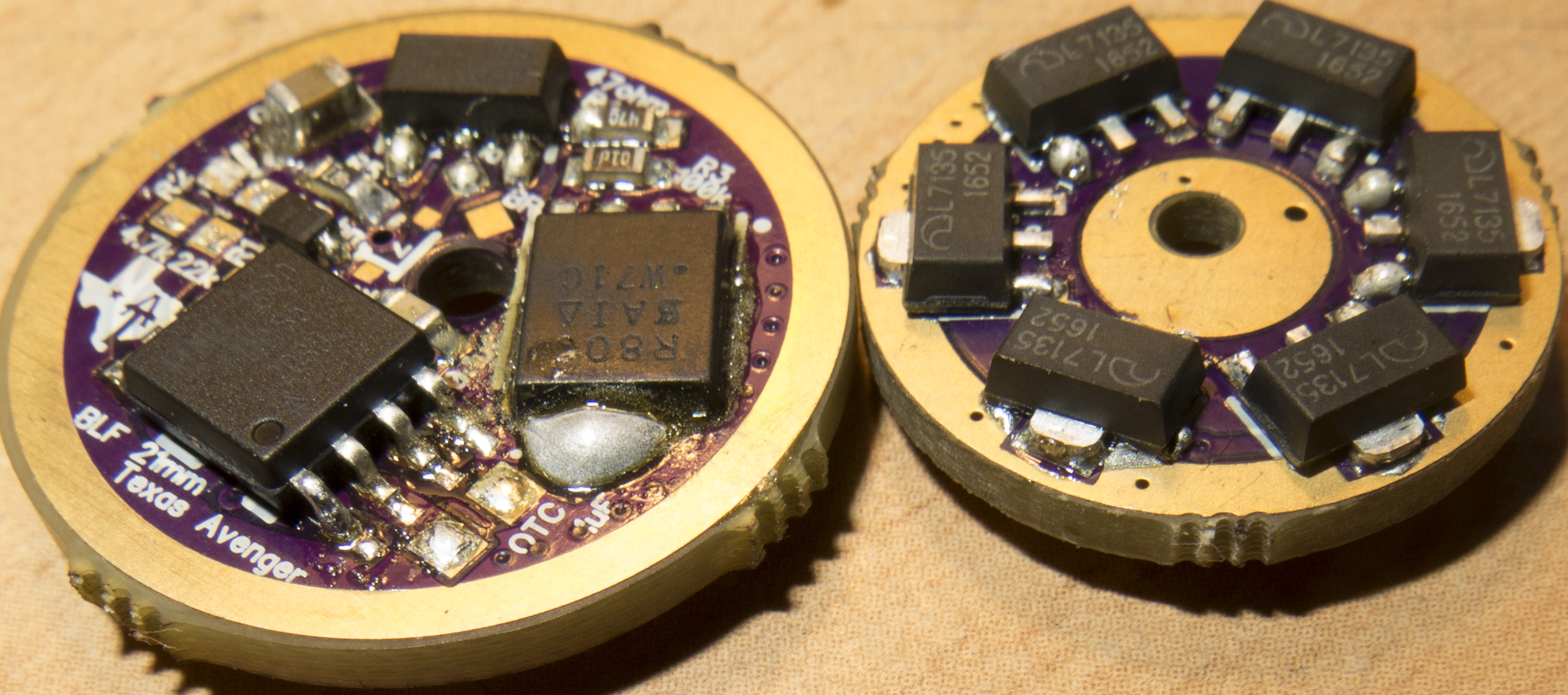

Today 200 AMC7135 arrived and from last drivers I had 2 boards over
so i could fit the rest of parts to them, 21mm fully reflow soldered, 17mm resistors and Attiny25 hand soldered
while reflow one 7135 (left side of 21mm) on the back shift position, got that fixed, even if it was electrically OK
need to use less paste especially on the FET, like i did on the 2. 17mm driver I did
and add solder with iron to fets pad, as its not easy to push it down and hold still till the solder gets solid with more than one driver under the heat gun later
it is no clean flux but it looks ugly if there is too much of it squeezed out under the FET
final reflow wil be cleaner as I make progress with it

Tried to do paste on the boards the first were OK, then it gets harder to squeeze out the paste and I get way too thin stuff containing almost flux
then the remaining stuff gets rock solid in the syringe
Crappy stuff they sold me, my lead free 10 year old stuff is better
I recycled some from the syringe and applied it with a toothpick
could do 10 boards with remaining fluxed solder paste
I had the same thing happen with some of my solder paste. I ordered another tube and so far it has been working fine. I think it is more a matter of age, the older it is, the more it separates.
Yeah, I bought a tube of solder paste from eBay a while back, and it was a bit dried out. They also sent me a tube of just flux as a bonus. I took the ‘needle’ off the tube of solder paste and squeezed it into a cup. Then, I added some of the flux from the other tube and stirred until there were no more lumps. I got as much solder paste as I could back into the tube, and it seems to work fine now. Maybe you can do something similar with yours?
I bought some Kester EP256 on ebay. Vestureofblood recommended it in one of his “how to” youtube videos. I’ve only used it a few times but it’s been working great. I’m pretty sure solder paste has a limited shelf life. The one I bought on ebay was fresh when I bought it last year with a date of manufacture written on the tube. —-
I’ve tried the lead free regular solder, but had a much more difficult time getting nice solder joints with it. So I just stick with the leaded stuff now.
