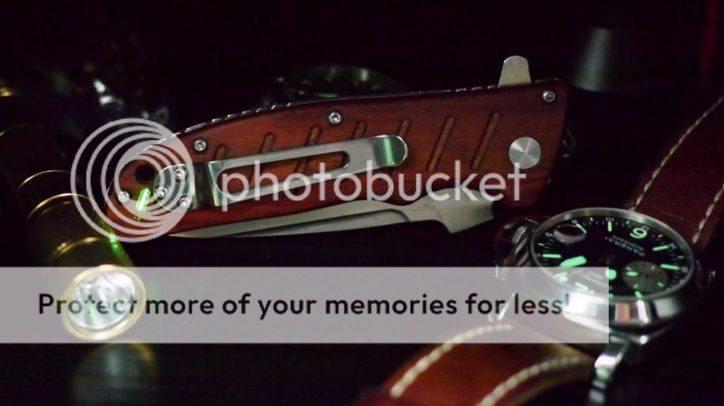

My daughter came down to my workshop to see what i was doing and got interested, so we added a trit to her el-01, looks pretty sweet with the new school tritium and old school wood liners contrasting nicely. after a couple of tests, I found that the NOA actually cures better if you do it slower, so i started about 1 foot away for 30 seconds then moved closer for 10 seconds once it was hard just to finish it off. No smoke this way and a much clearer cure.
Excellent news on the NOA curing, I figured it’d be among the best out there according to the specs.
Pretty sweet!
That green trit does indeed look nice in the wood scales. Nice work. ![]()

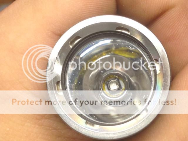

My L2C is together!
I was able to fit the LZ1 on an xml color sinkPAD so I’m running it slightly overdriven @ 1.4A.
First I cut the traces from the 2 center connections on each side and marked it to cut it down to 16mm to fit the P60 pill.
Then cut it down and had a hell of a time breaking the contunity between , - and GND doing so caused. I had to cut away the outside of the and - pad’s.
Mounted
I’m using a UI I developed for weapon mounted / tactical lights. 100% on and a hidden strobe.
C-K: how is the fun seeing the performance for the first time ?
I was having a great time pointing it around at everything :-)
I know how it is like to sand down 20mm XML-colour boards to 16mm, I have done that twice and yes I got shorts as well that I had to fix :-(
