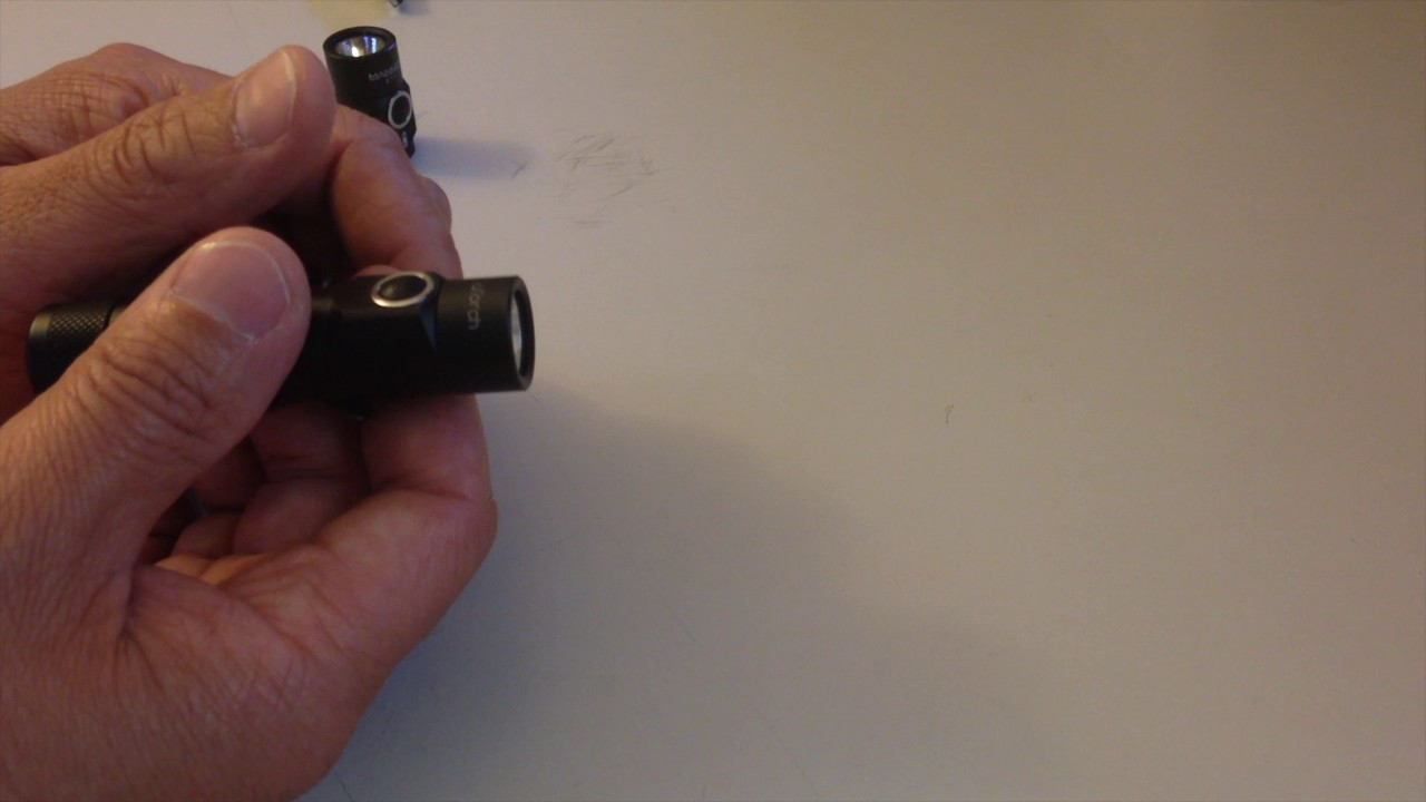

Some AA size lights for size comparison
18650 sc63w/16340 PK PR1 and 16340 HDS rotary hi cri
Little size line up, all 16340 up to the black D1, then 18650 till the sc5c mkII AA on the end
s2+ thrown in for size
all 18650
