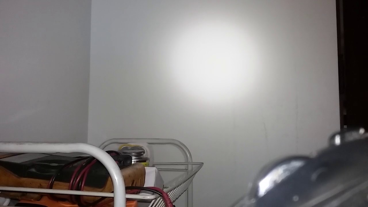

The emitter is listed as being an XP-G2 R5. The tint isn’t listed, but it’s quite neutral looking with the slightest hint of green. The emitter was well centred prior to me removing the pill. However, due to the centre ring / gasket design it took a few attempts to realign upon assembly. I am far from experienced (AKA a newb) with gasket design and emitter focusing, but it appears that the gasket may be slightly taller than needed and could be causing a slight loss in light output. However, the beam seems to be nicely focused when white wall hunting.

I found this light to have quite a nice tint with plenty of output on AA and a tight hotspot with reasonable spill. Indoors the tint has the slightest hint of green, but is quite pleasant and Mrs Mapache commented that she really likes the tint colour and finds it relaxing compared to the “harsh” 1A tints. Outdoors the green was not visible to my eyes and the tint was excellent for inspecting wildlife burrows for activity and seemed to make the vegetation stand out well. On a number of occasions, I had the light clipped to my baseball cap for inspecting fence lines and wildlife cameras. Most of the time this worked well, but I found that the hotspot was a little too narrow whilst wearing an old and loose-fitting flexfit cap that refused to stay in position due to the increased weight on the peak. However, whilst wearing an adjustable style cap I had no issues with the narrow hotspot as the cap would stay in place with correct adjustment.
