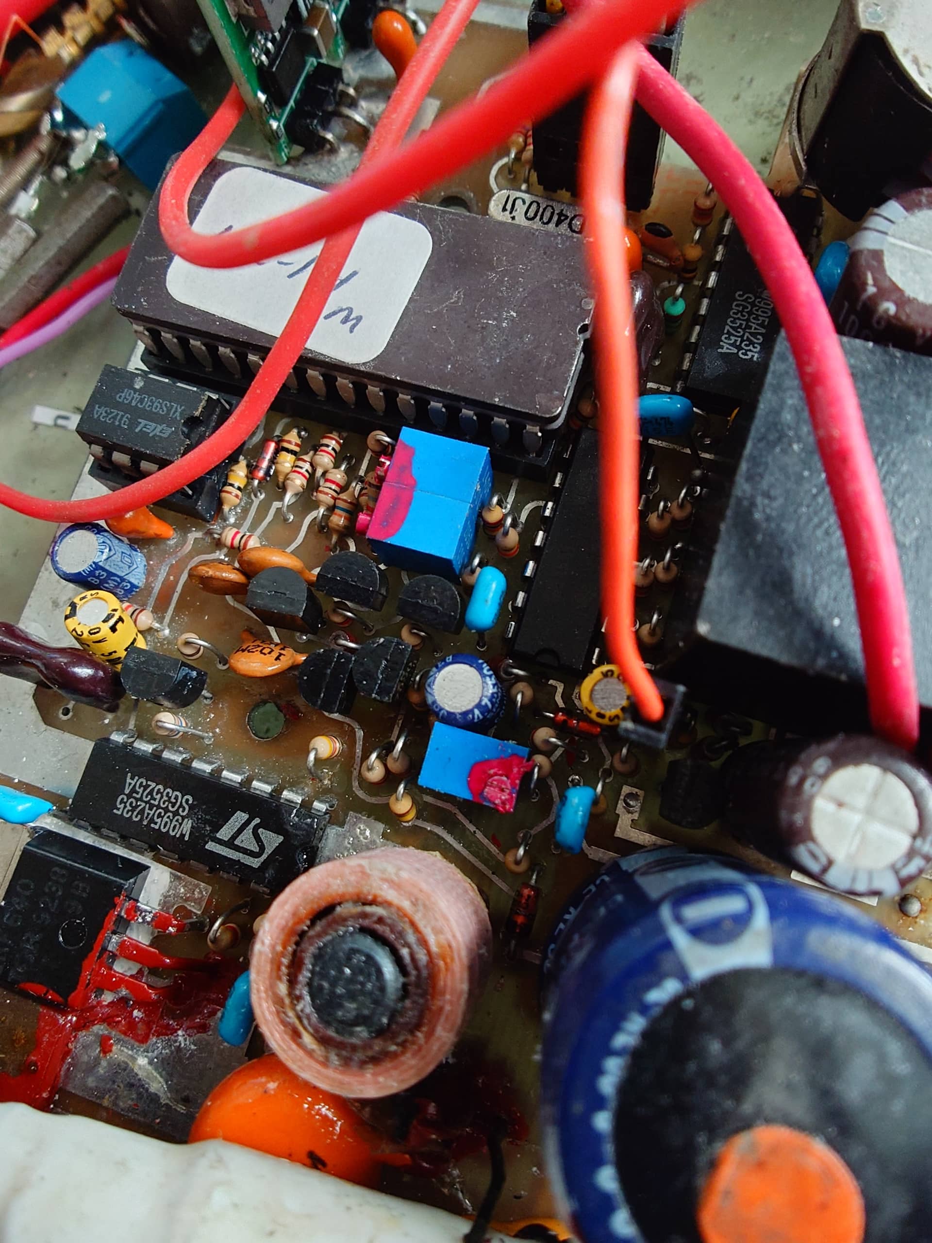

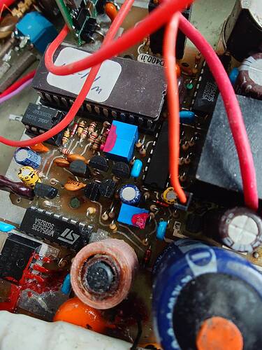

There are three adjustable potentiometers. Starting from the top…
Top: Adjusts the “always-on” output. This determines the default brightness level immediately after turning on the Maxa Beam.
Middle: Determines the power saver (low brightness) output.
The output cannot be set below approximately 75W. Note that excessive adjustment can cause a conflict with the top potentiometer, resulting in the output being locked at 50W or rendering the output switching commands (via the handle’s 4-position button) completely unresponsive.
If such issues arise due to excessive adjustment, you must turn off the Maxa Beam, readjust the potentiometer, and then turn the unit back on to verify the output change and restore proper operation.
Until the setting enters the normal operating range, the Maxa Beam may remain locked at approximately 50W or fail to adjust brightness correctly, which might lead you to believe the unit is malfunctioning. Do not worry; restoring the middle potentiometer to its proper setting will return the unit to normal operation.
One issue to note is that while adjusting the top potentiometer results in an immediate change in power output while the unit is on, adjustments to the middle potentiometer do not take effect—or rather, the applied value cannot be verified—until the Maxa Beam is turned off and back on again. (This can also lead to the mistaken impression that the unit is broken.)
The final potentiometer controls lamp ignition. Excessive adjustment will cause operational issues until the setting is restored to its original state.
  • If set too low: The active Maxa unit will suddenly shut off. Afterward, pressing the red ignition switch on the handle yields no response.
  • If set too high: Ignition occurs accompanied by a loud, explosive sound from the spark gap. It produces a harsh ignition noise and a pungent ozone odor. While this likely won’t cause major functional problems, the significantly louder, menacing noise is quite unpleasant and could potentially generate substantial EMI noise.

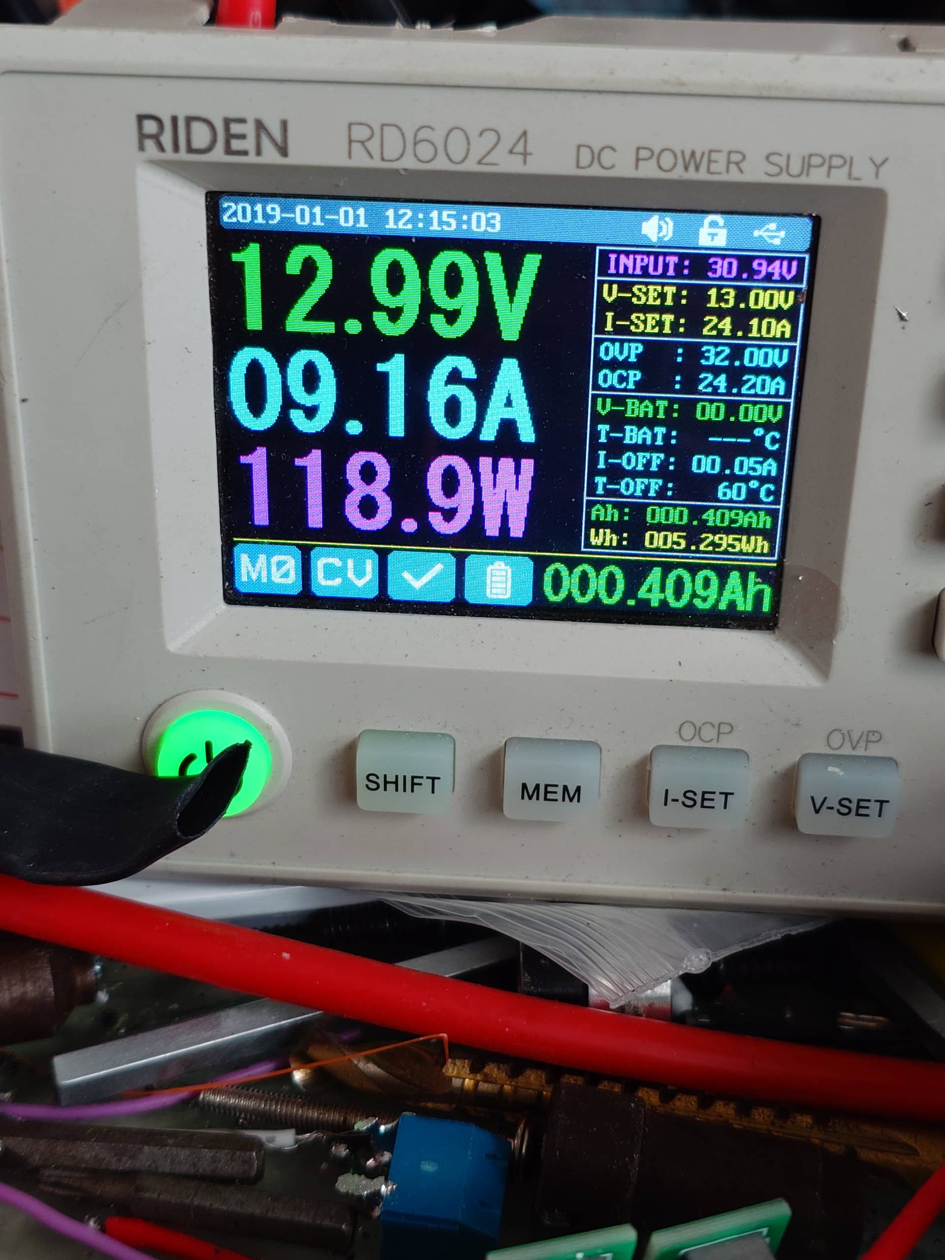

Ultimately, it can achieve figures of 75W in low-power mode and 140W in standard output mode.
(Note: The efficiency of the Maxa Beam ballast is known to be approximately 90%.)
Output drops when the FET and diode overheat. This photo illustrates such a case; there are no heatsinks or cooling fans. Consequently, the 140W output began to decline after about five minutes, and by the ten-minute mark, it had dropped significantly, as shown in the photo.

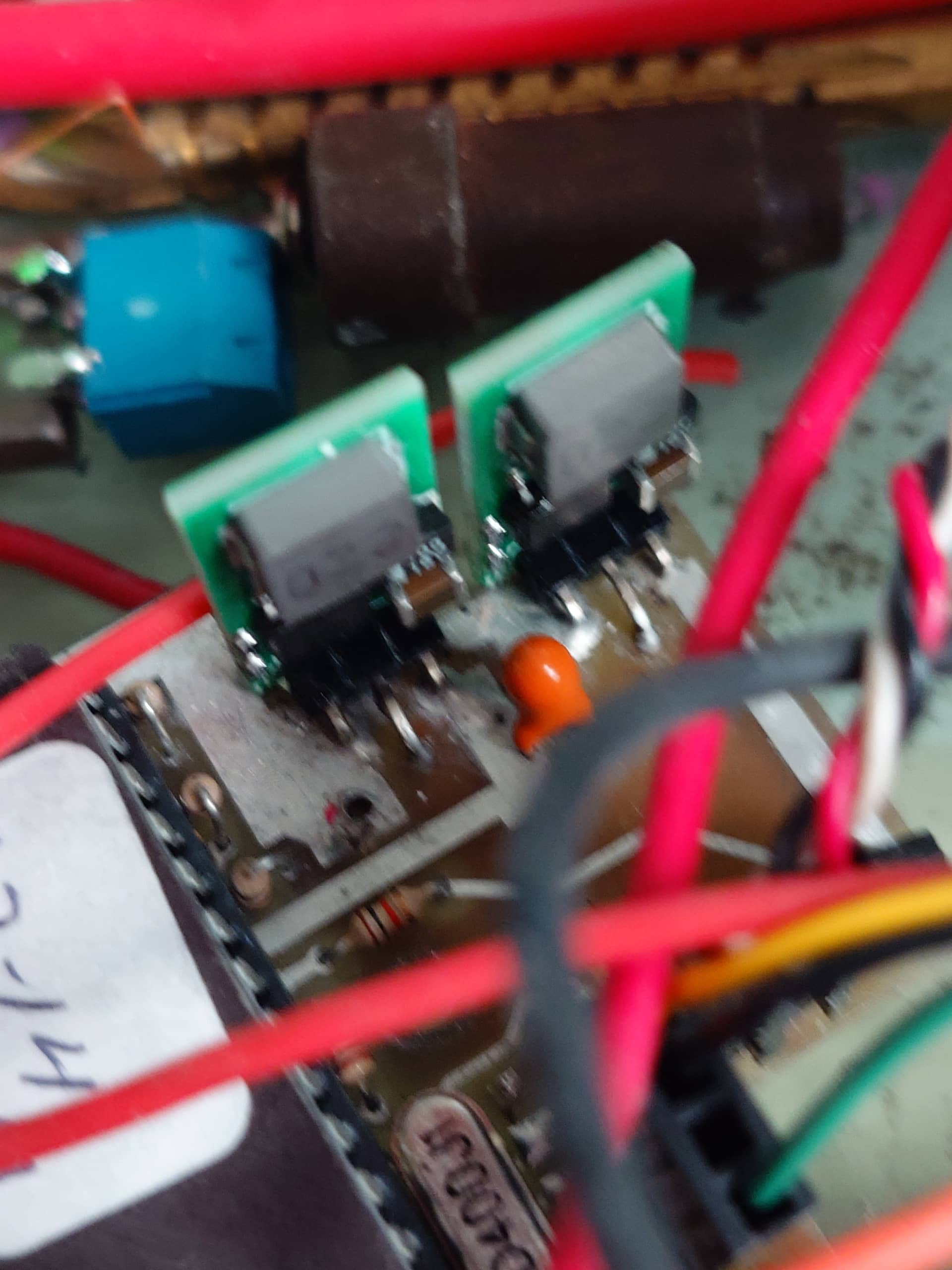

Replacing the LM7805 with a switching converter.
To be honistly, back when the Maxa Beam was originally designed, the 7805 was a highly popular, easily accessible, and reasonably reliable 5V regulator.
However, numerous switching converters that are smaller and generate less heat are available today; using one allows you to replace both the Maxa’s 7805 and its bulky heatsink, offering advantages in every respect.
It still works well. However, there is still a long way to go.

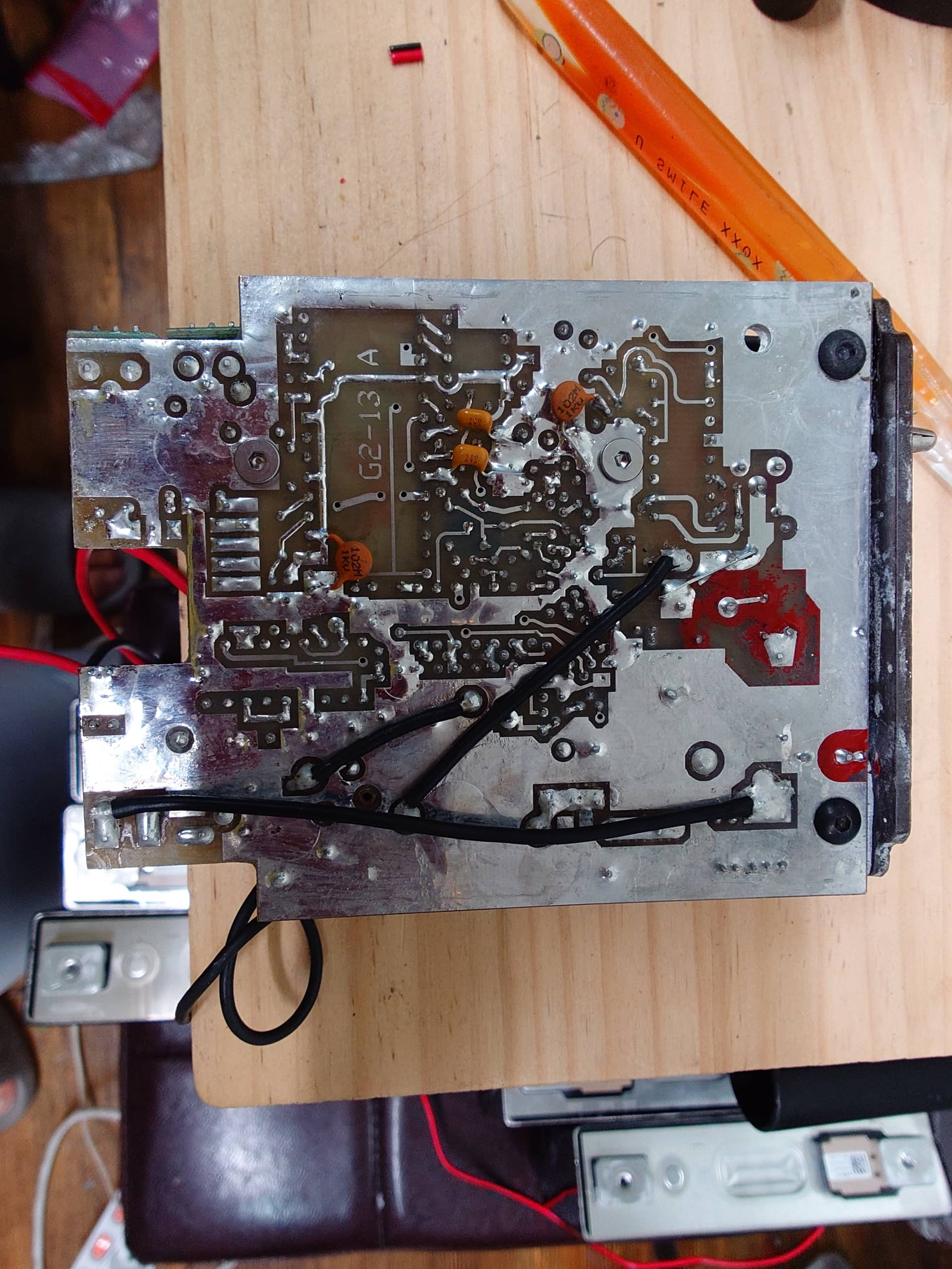

High current area reinforcement.
Finally use 15AWG, Jump the high current side node to node.
While Maxa’s PCB is excellent, it is not designed to handle a high power output of 140W. (It can withstand it, but heat generation would increase, ultimately leading to reduced efficiency and a drop in power output. That would defeat the purpose of the RE:MaXa project, wouldn’t it?)

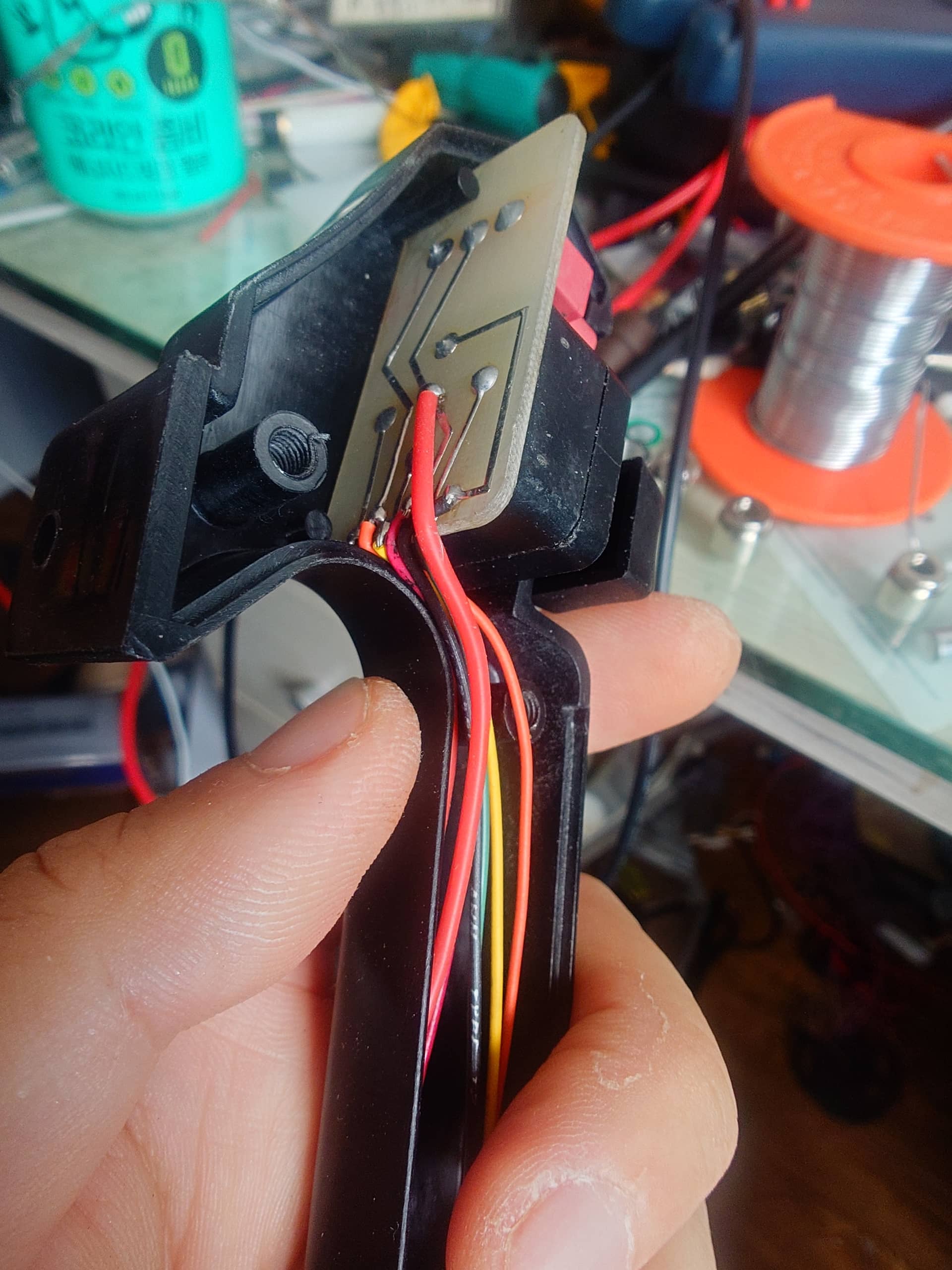

Modified the wiring to remove the “Turbo Boost mode” from the handle’s 4-position switch and reconfigure that function as an “LED assist mode.”
Since the “Hi Power” setting has already been adjusted to 140W—the maximum power output the Maxa is capable of—the Turbo Boost mode is no longer necessary.
For reference, this is the Maxa Beam MBS-450 Gen.2 mainboard.
The MBS-410 Gen.2 mainboard should be identical in this regard.

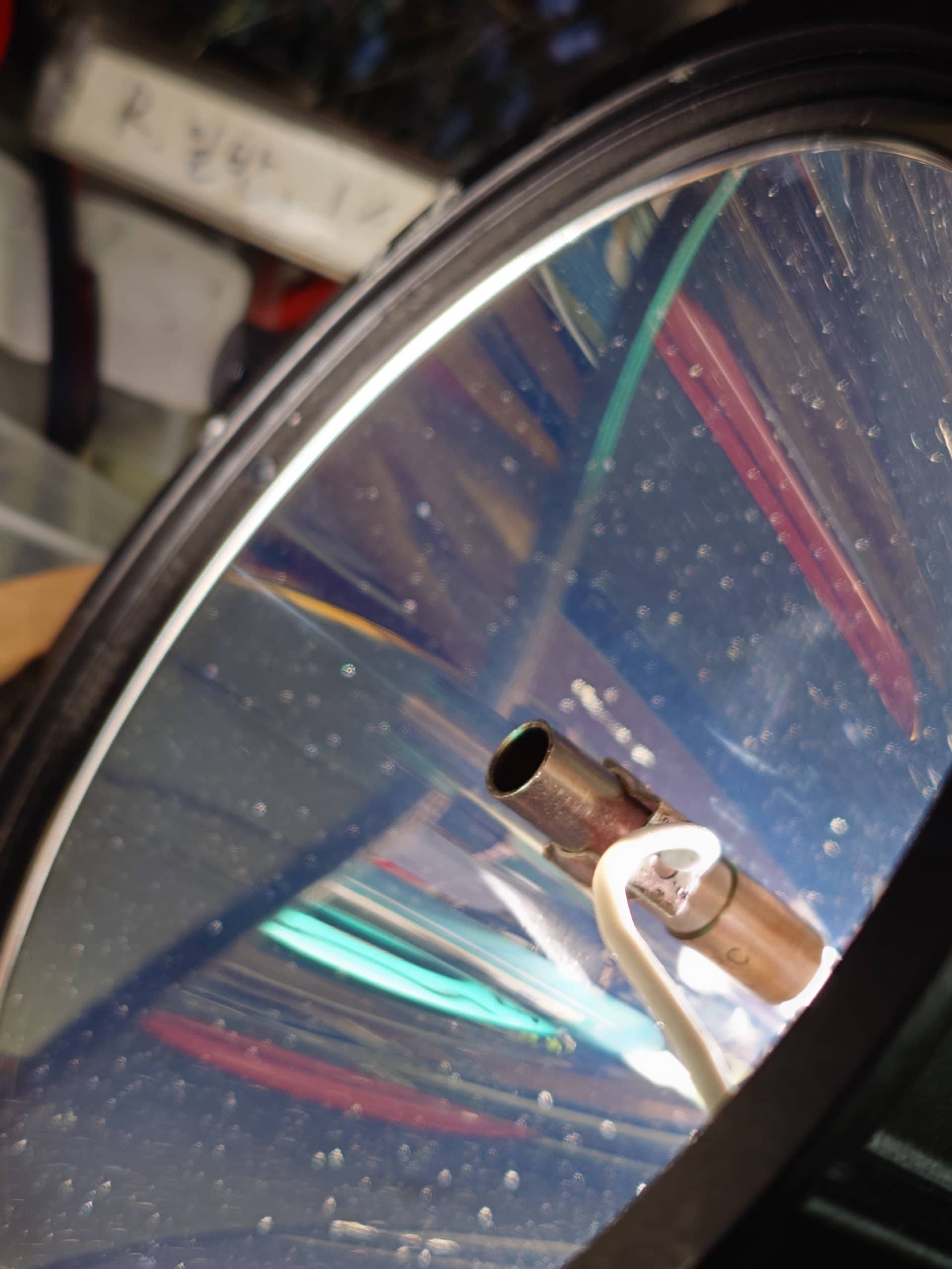

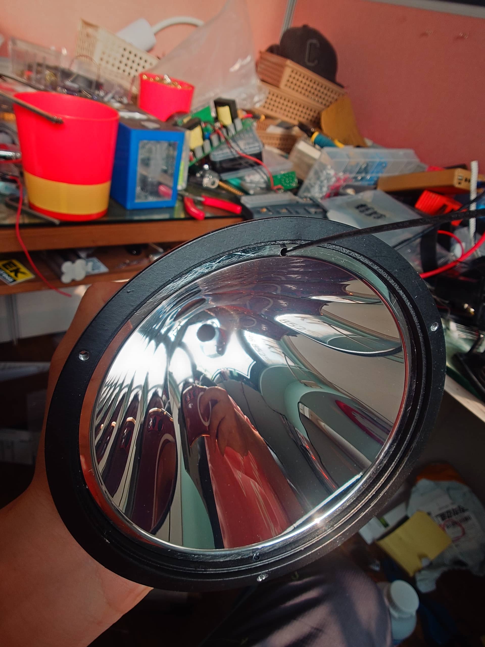

A crucial point to note is that you must absolutely not modify the reflector assembly until it has been replaced with the 3rd-generation “enhanced” reflector. I contacted the manufacturer, Peakbeam Systems, and was advised: “Do not modify it under any circumstances, as the reflector assembly is replaced as a complete unit.”
Consequently, I plan to proceed only as far as modifying the motherboard and building the battery pack, holding off on the remaining work until the reflector has been swapped for the 3rd-generation enhanced version.

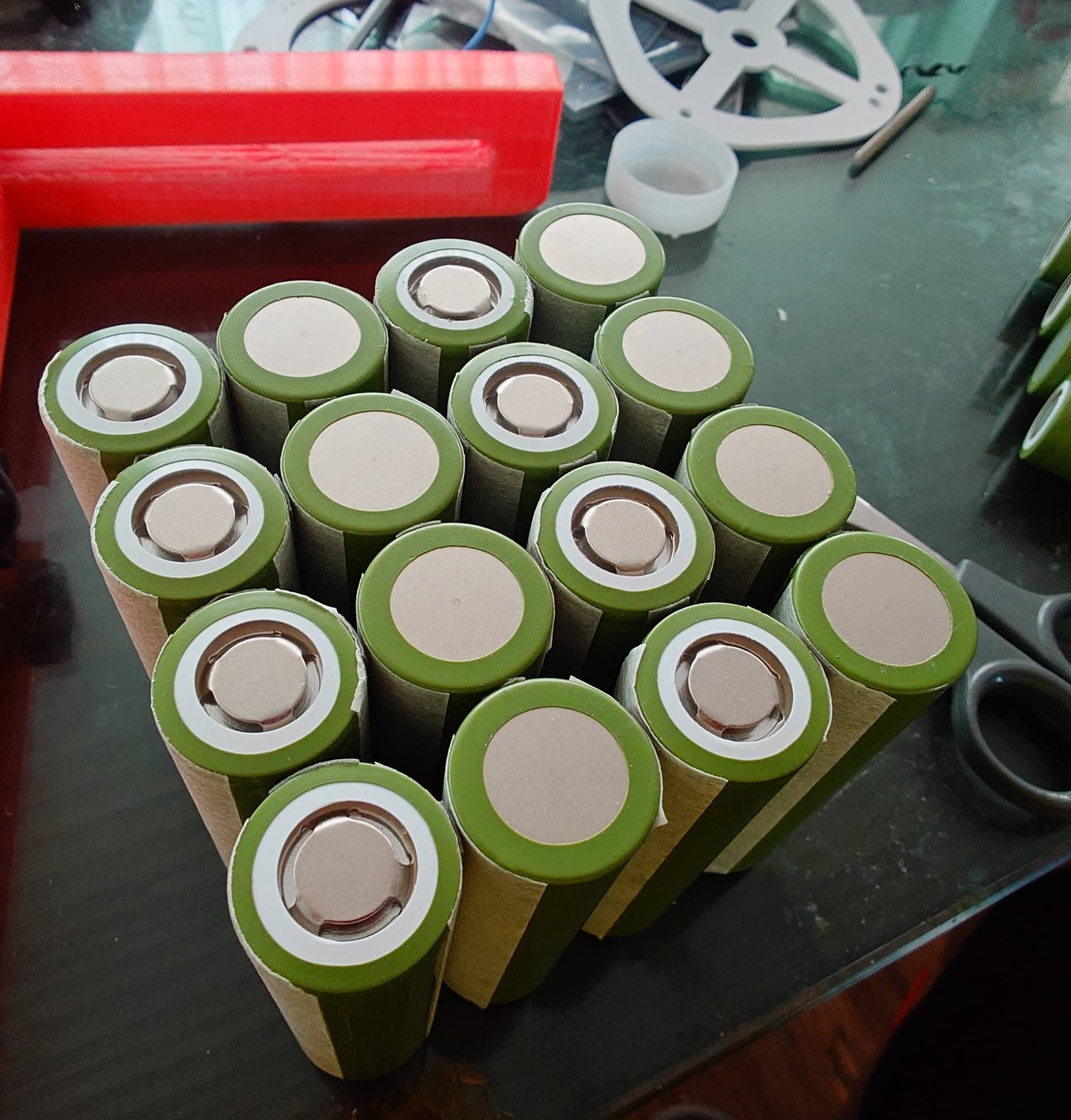

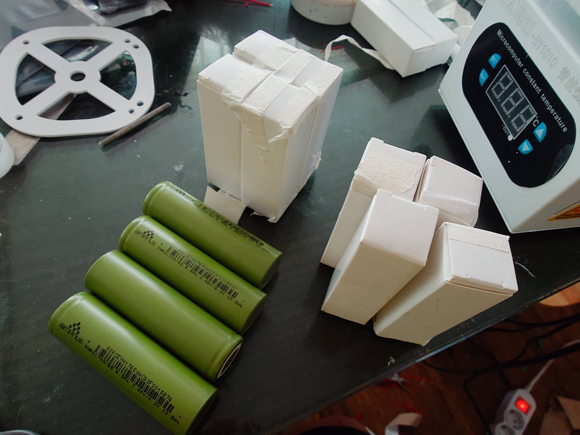

and… my Maxa’s power battery.
amprius 6500mah.
