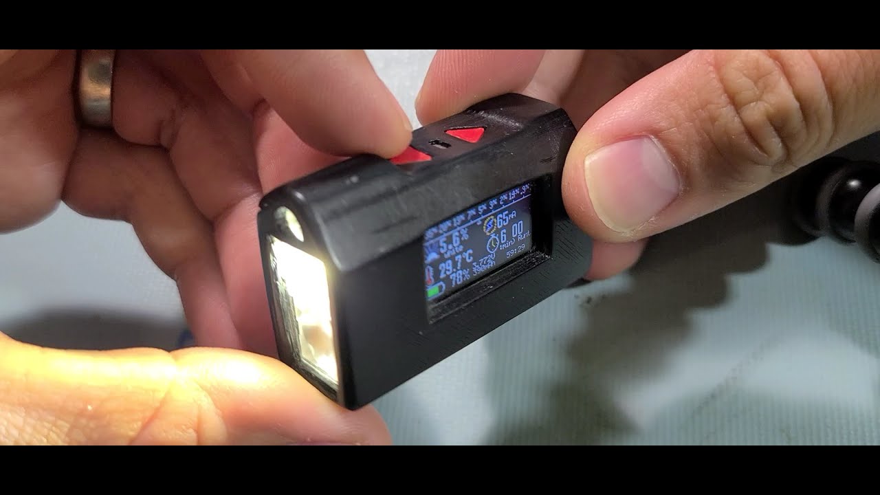

Here’s version 2 of my Min/Max light - a flashlight built from scratch with the aim of having the minimum size with the maximum functions. I shared version 1 here.
This time around I designed and built this light from the ground up instead of modifying an existing light. I included every feature I could think of for a small EDC light:
- adjustable brightness
- red, green, and blue color modes
- ultraviolet
- a green laser
- USB-C rechargeable
- temperature control
- battery power instrumentation
- a graphical color display
- a tail switch as well as up and down switches
- a touch sensitive panel
- a tailcap magnet
- and of course this includes all the functions of my previous MELD flashlights - strobes, configuration options, automatic shutdown, etc.
I managed to fit it into a final size of 51x30x17mm.
The structural parts are 3d printed in ABS. a central plastic frame holds all the electronics wrapped around the lithium battery, and there is a heatsink formed from a folded copper sheet that wraps around the right side.
To get this to fit into the smallest package possible, I put all the electronics including the emitters onto a single flexible PCB. This PCB is folded to cover 4 sides so that it can hold emitters on the front, a display on the side, switches, touch panel, laser, and charge jack on top, and a tail switch on the back.
This light does all the same stuff as my other MELD lights, with the addition of the green laser, USB charging, a third switch, and of course the color display. The the display always shows mode, LED temperature, battery charge status, drive current, and a remaining runtime estimate.
Here’s a video with details on the build process and demos of the finished light:
