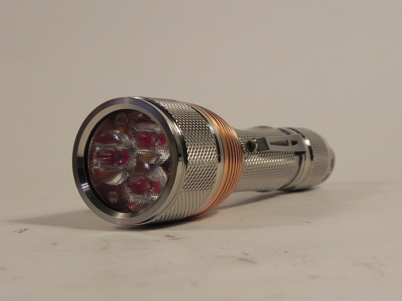

Hi,
i did the my first triple Mod of the X6 SS/CU. Driver was swapped against MTN17DDm. I used 3x XP-L Hi V2 3D, a heatsink from hoop, springs bypassed etc… The light makes 3585 Lumens (3777 on startup) on a VTC5.
I have 5 more heatsinks (and 2 for the old X6), so there will come more soon ![]()

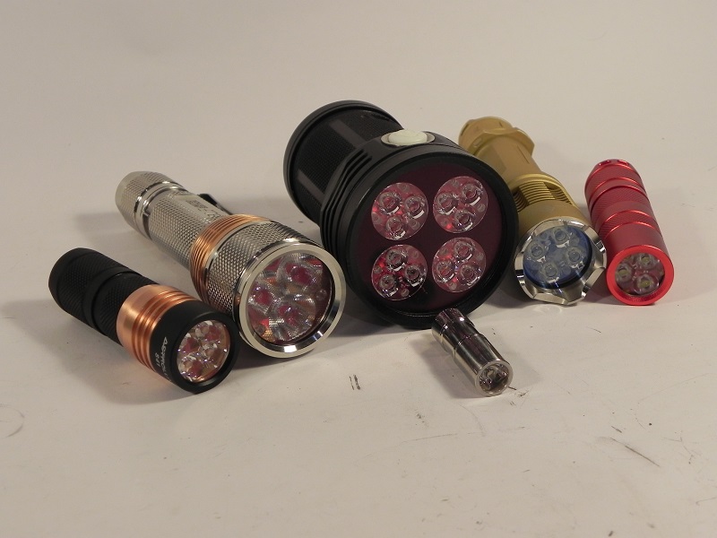

The light fits very good in my little but colorful TIR collection but i still like my Roche F8 Quad (4x XP-G3) a bit more at the moment.
Regards
Kenjii
Nice collection Kenjii.
